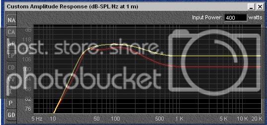

I have been loocking some replace some for my subs, and i found the TC-1000 10" like a good option cause it handles the power i have, but have a lot more features than the Pioneer i have.
My question is when i enter the T/S and design the box, the Pioneer seen to be louder in the program than the TC, and that WOW me, dont know if i'm doing something wrong this have never happen with any of the preview design i have done.
Could some one help me with this, is there a problem or is just that the pioneer are louder in the simulation.
The box is the same for both speakers 1.2cu.ft@33hz.

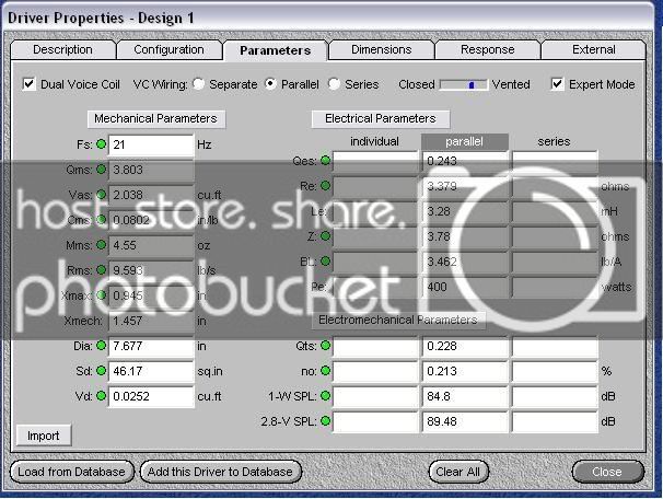

Here are the T/S for the TC-1000 10"
This is the image of both subs yellow is the pioneer, re is the TC.
