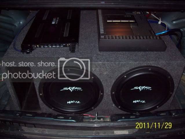

Well I am not a noob - I am 38 years old and have have a system in every car I have ever owned since I turned 16, thats 22 years for you math challenged.
I would prefer to mount them somewhere else but there is no room.
How u liking the skars?? I planned on running them but no dual 1 option...
