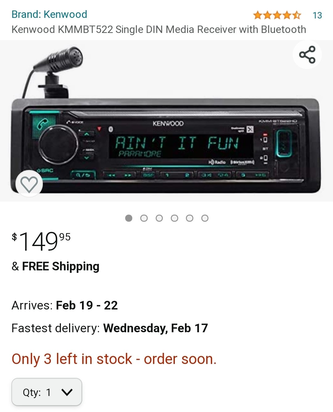

I picked up a Kenwood bluetooth HD receiver for like $120. 4v pre-outs. I think it's a KMM-BT522HD. I have it running my over 3K daily set-up.
