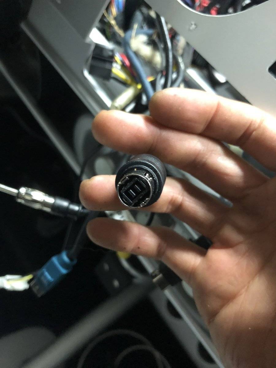

I am looking to change out and update my current Alpine headunit (circa 2010) with a more modern JVC headunit. After digging through my current system and wiring, I noticed that my amplifier's 3 pairs of RCA cables (front, rear, and subwoofer) are all tied into this Alpine "PXA-H100 IMPRINT" module that appears to join the channels together and processes equalization... and at the other end, into the headunit, is this cable:
What is that connector called? Do modern day Alpine headunits still have that port?

thats the alpine proprietary AI-Net plug. They used 2 types of connectors back in the day, AI-Net and M-Bus, this is the former. It was for cd changer controls, ipod connectivity etc before the widespread advent of USB in cars.
I was out of the audio scene for several years, so i dont know when Alpine ditched AI-Net, but im about 99% sure they did indeed ditch it.
