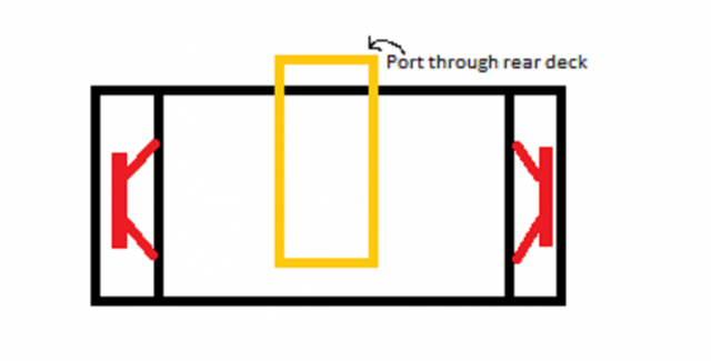

I want to build a 4th for my Lexus GS300 and port through the 9" hole in the rear deck that the factory sub used to be mounted in.
I have a max of 5 cubes gross to work with.
It would be nice to use some subs I currently own.
I also have read that you want the subs as far from the port as possible (not sure if this is 100% true)
Because the port has to fire up through the center of the deck it puts the port right in the middle of the box.
I made this very crude drawing of how I think it could be laid out.

Also who can give me a design here?
Sorry man but that is beyond my understanding.
Could you explain it to me or perhaps tell me if the Alpines would work good as I think they are the best match for what I am looking for.
If you learn how to calculate now, you wont ever have to second guess yourself or rely on another's advice which can be wrong or right. You can just confirm it with your own scientific calculations. By calculations i mean google EBP calculator. Then look up TS parameters on your sub models and enter in the calculator viola done.
My speculative guess both alpine and JL will work. Zvx will sound like trash in a 4th. Just personal opinion not verified by any calculations.
Calculate the EBP and if its 50 and under, you can use it in a 4th.
EBP is fs/qes and tells you what type of box the sub favors. EBP under 50 means the sub is suited to a sealed box and would also be suitable for a 4th order.

Plugging in both the Jl and Alpine specs gives me EBP of over 60 on both of them
So now I am at a loss. This is also weird as JL seems to really recommend this driver in a sealer box, I currently and running them in a seal box and am rather unhappy with the sound.
So can anyone recommend a pair of 10" drivers (I think that is going to be the best driver based on the size I have to work with) that are not too much money.
it is a bit frustrating that I have a whole collection of drivers and none of them will work right in this application.

So what would you run?
What I would like is the driver that would use the least amount of space.
can anyone tell me between the Skar and the Alpines which would work best in a smaller box?
I really do not want a large box in this car, so the smaller the better.

skar and alpine would do fine in a 4th. Flip a coin. They are actually pretty similar in enclosure size since alpine does decent in pretty small boxes as well and the skar is obviously an 8.
Well surprisingly the 8's take a darn huge *** box. My last one was 2.6 net
I believe the Alpines and the Skars would take the same size box, of the 2 which do you think would be better output?
The Skars are smaller but have a further excursion than the Alpines.
i'd personally do the alpines because they just sound better, i dont like the sound of the zvx series, however i only heard the 18s.
