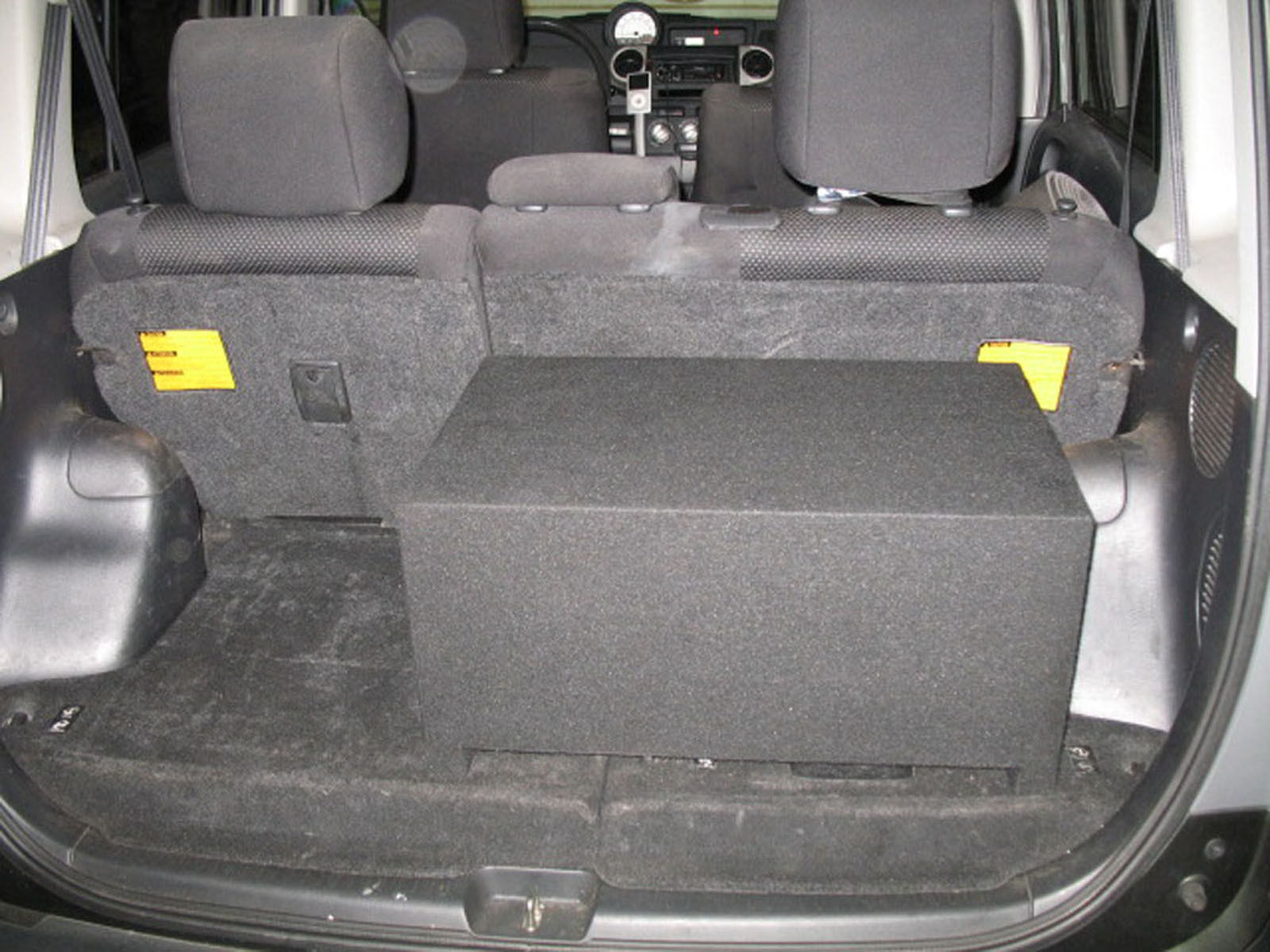

I just picked up a Scion Xb to use for daily duties and need a sub setup that will let me use the storage area without worrying about the subwoofer getting damaged.
I found this prefab downfiring box that would be perfect.
Here are the specs of the box.

this is how the box looks and would work perfect as I could toss anything back there without worries.

man if u ain't got box yet i wouldn't get it.. the port is just to small for the box man it's 7.9 sq in per cf., should be almost twice that.. i think it's waste of $

Pm Imjtnotu, and talk to him about one of his lightning audio 10s, in a 1.5-1.8cuft net, put the sub on top of box, and port back will protect the sub, and be sensible with the gain, would be decent in that size vehicle dude.
