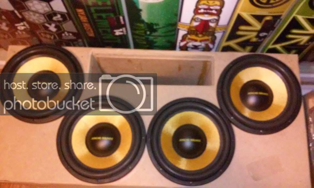

I have a box that the internal measurements are
PLEASE NOTE: 4 of these 12's will be going in this box
Box-
Height 19"
Width 43 1/4"
Depth 22 1/4"
Port-
Height 5"
Width 19"
Depth 17 1/2" to the top of the box (take away 1 1/2 inches for the double baffle top if you are suppose to take this measurement internally.)

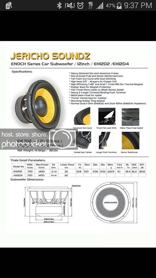

Here are the specs for the subs I have.
Does everyone agree with C1500martin's figures based on my measurements given? I appreciate his help very much but always welcome a second opinion to make me feel better.
