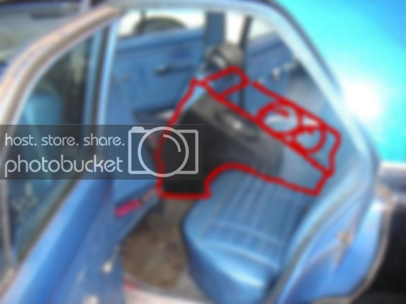

I cant realley go any longer on the port than 20"
the box is a bit oddly shaped and going between my front and rear seats in my old school whip that used to have a fold down arm rest on the front bench I took out.
this box is a sealed unit I made - but did not like due to having one sub firing fowards...
new design is both subs firing bckwards and port at the top -
trunk is filled with hydraulics and batterys - so no chance at a sub box back there
super duper lol at this quick sketch of placment haha
