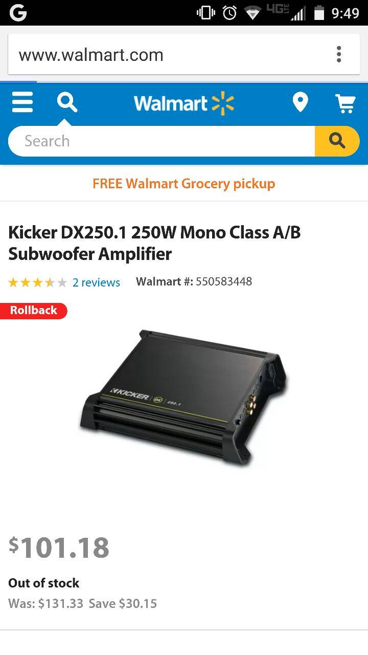

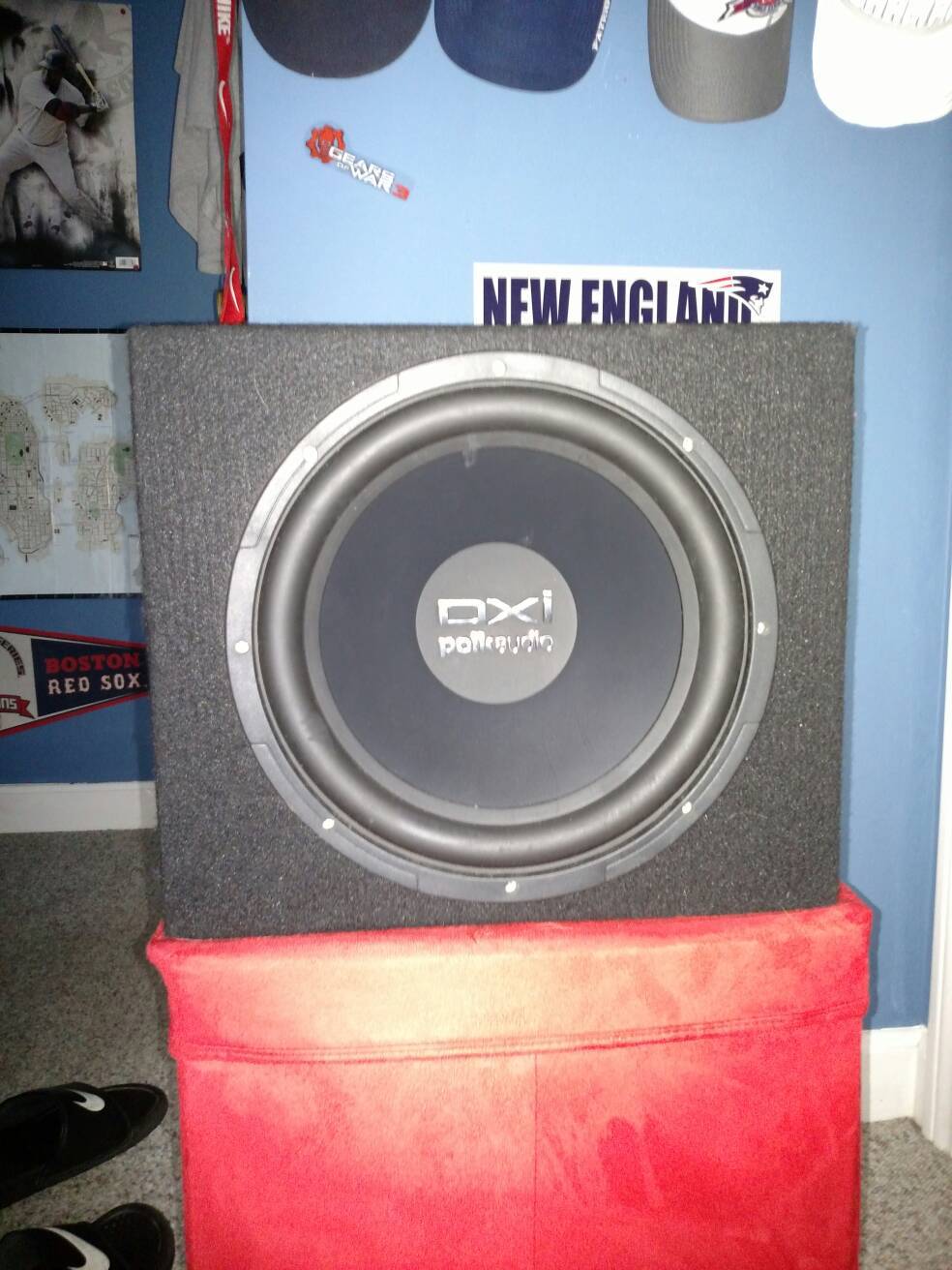

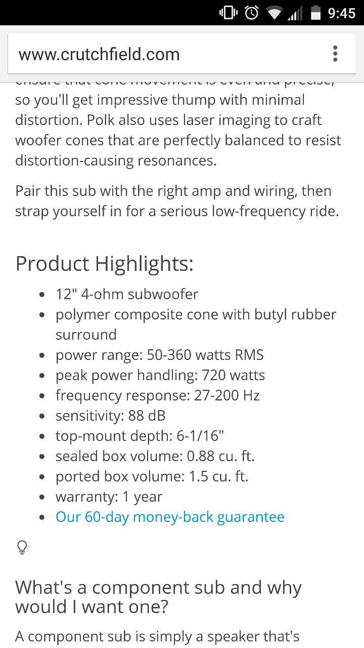

I just picked up this kicker amp for $30 off a friend and was gonna pair it up to sub I picked up on the cheap a few months ago. I was looking for a recommendation on what gauge wire to use, and a link to one on Amazon if possible. Thanks!
