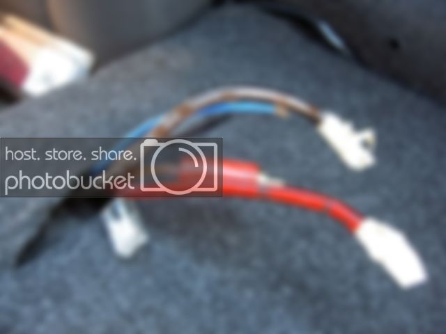

Hey everybody I have these wires running into the trunk and I think I know what they are, but I'm not 100% positive. I bought this 2002 Ford Mustang (Non-Convertible) with a Mach 1000 Stereo system! I'm adding one 12" CVX with a Kicker ZX750.1 amp and I stumbled upon these wires here:
From what I can see there are:
(1) Set of power cables (+/-)
(1) Remote turn on? (Blue wire)
(1) Bass Knob Wire? (Phone-Like Plug)
(1) Set of RCA Cables where I could not find where they went!
Are those right? I'm really new to all of this stuff so correct me if I'm wrong. Also, if there are any installers in here that have worked with the Mach 1000 Stereo system how hard is it to get the sub/amp to work with the current setup? Thanks very much.
Alright, and no I did not find a remote but I did see the end of the cable. It's under the steering wheel column tied together waiting for a knob I guess. The job looks very clean overall.
