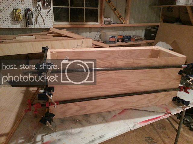

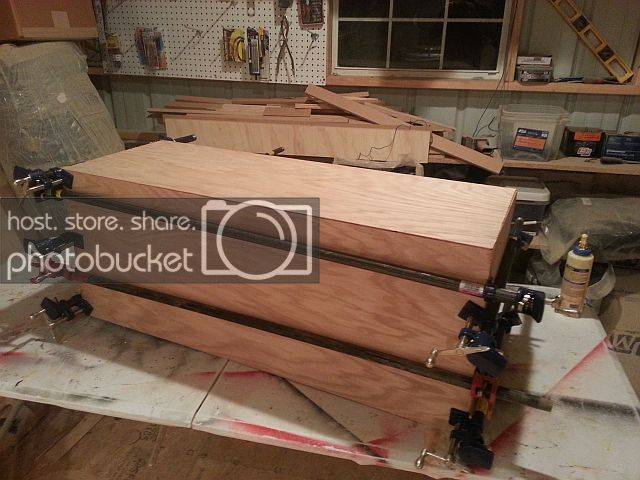

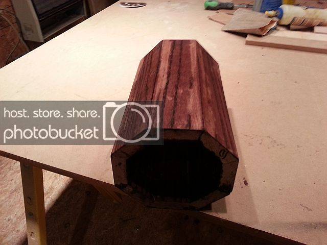

This is going to be a slow process over the next few days in between other builds I have going but here it goes....It's going to be an Oak Plywood constructed enclosure with solid oak octoport and more than likely solid oak trimmings on all corners.......It will be braced internally including 45s in all corners with mdf......This is for his two ID subs......4 cubes net 30hz.....
