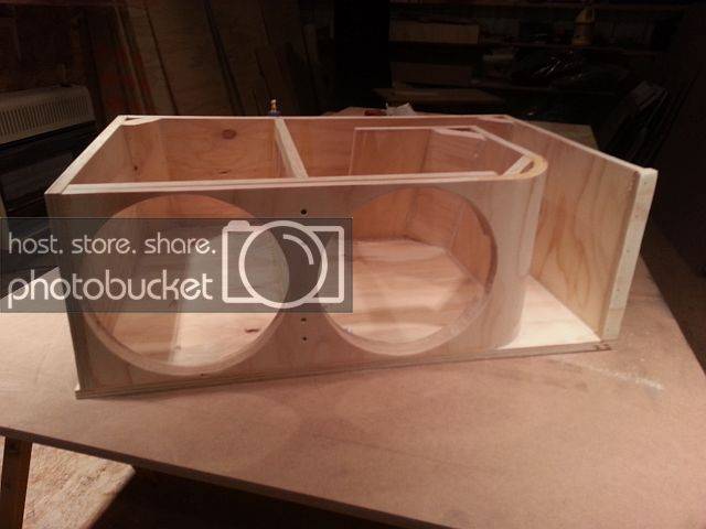

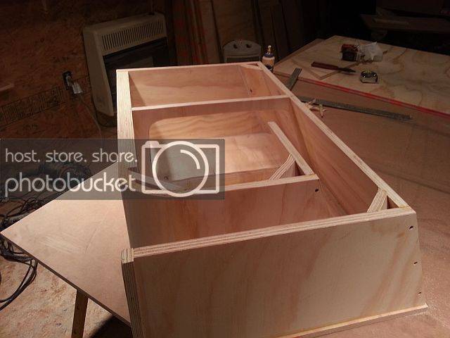

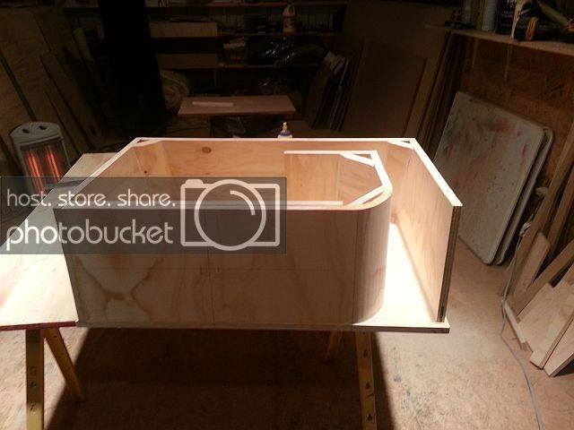

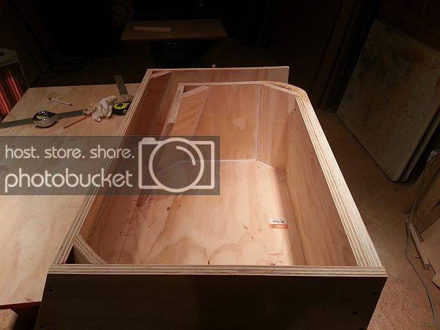

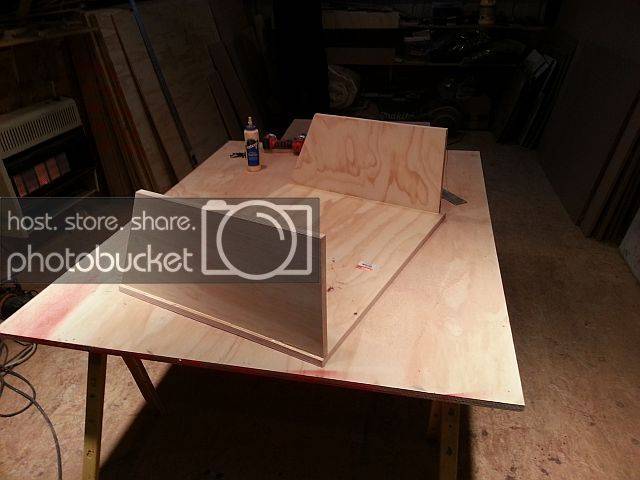

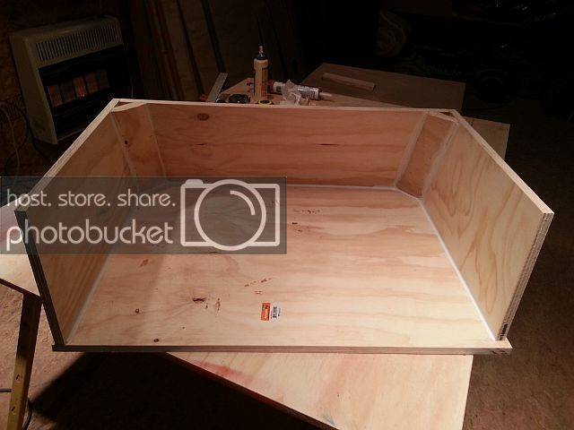

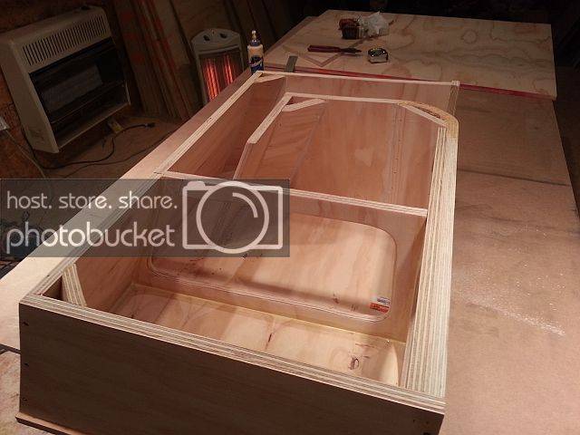

This is going to house a pair of DC XL 12s.....Arauco Construction.....Kerf port.....3 cubes net @ 33hz and plenty of port........bang bang!!!!
Lol at least you're used to not having trunk space. She'll sound like a dream I'm sure. I still show my SMS enclosure off to everyone I meet at this point lol.
im running a SMS enclosure now jsut getting way more port and a tad more airspace //content.invisioncic.com/y282845/emoticons/smile.gif.1ebc41e1811405b213edfc4622c41e27.gif
