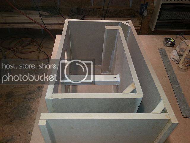

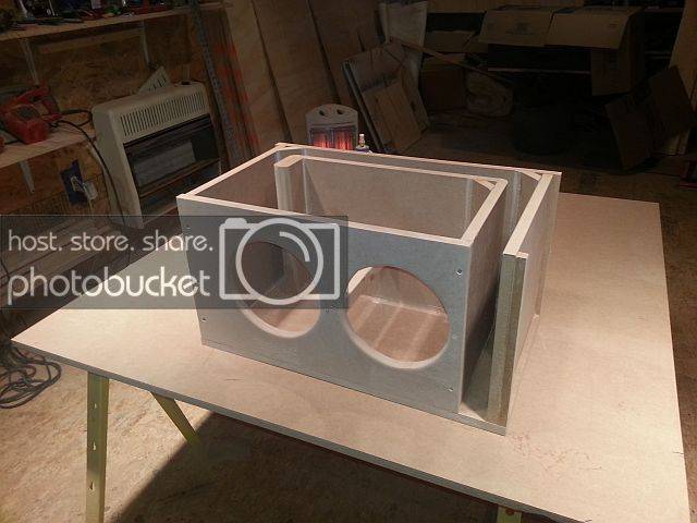

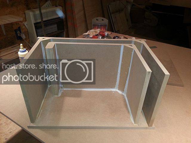

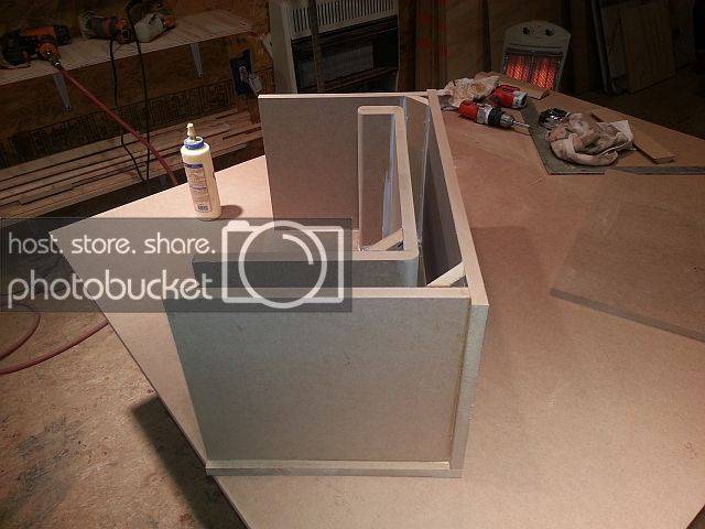

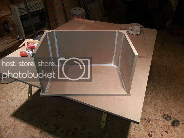

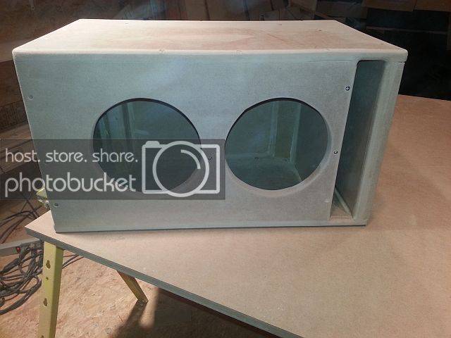

This is for a pair of SA 8s.........1.25 cubes net....32hz......
What router bit did you use on the flange at the internal end of the port? Looks so clean
1/2" round over ....I bought a Rigid mini router a few months ago and I love it....It's one of my favorite tools in my arsenal......
