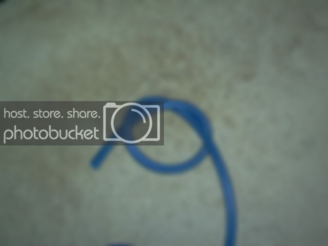

i use welding cable and it's just as flexible as most any CA wire. i'll try to snap a pic to show how flexible it is
I got one boss! I didn't pull it real tight either though.
