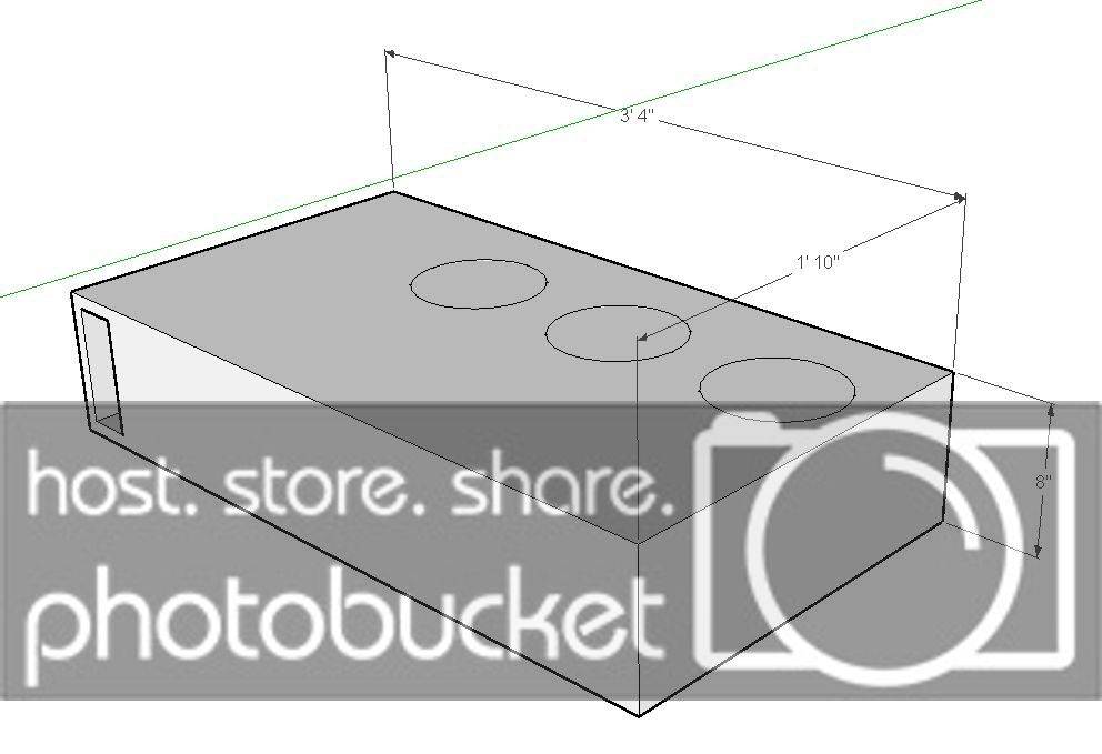

So I got my design that I will be using. I have never used a tuning box program. I have no knowledge of figureing out how many subs I can run, etc. I'm useless, LOL!
http://www.the12volt.com/caraudio/boxcalcs.asp shows the box being 3.8 net.
I want to run 3 DD1508 subwoofers. I just don't know the setup I need. I know I want to run round ports.
2.25^ft (2-3) 8" 36.0 sq" vent x 16" long tunes to 40Hz
2.50^ft (3) 8" 40.0 sq" vent x 16" long tunes to 40Hz
2.75^ft (3) 8" 44.0 sq" vent x 16" long tunes to 40Hz
3.00^ft (3-4) 8" 48.0 sq" vent x 16" long tunes to 40Hz
http://www.ddaudio.com/dd/caraudio/enclosureInfo/boxSize_hiEff.asp
You have plenty of volume, but the port direction and loading are going to be an issue.
That face of the box are you planning to mount to sub on?

i am having trouble figuring out how to run the round ports. if i put the subs in the middle, the same with the rounds ports on the 6" piece of wood. going by dd website the port needs to be 16" long. it runs into the magnet.

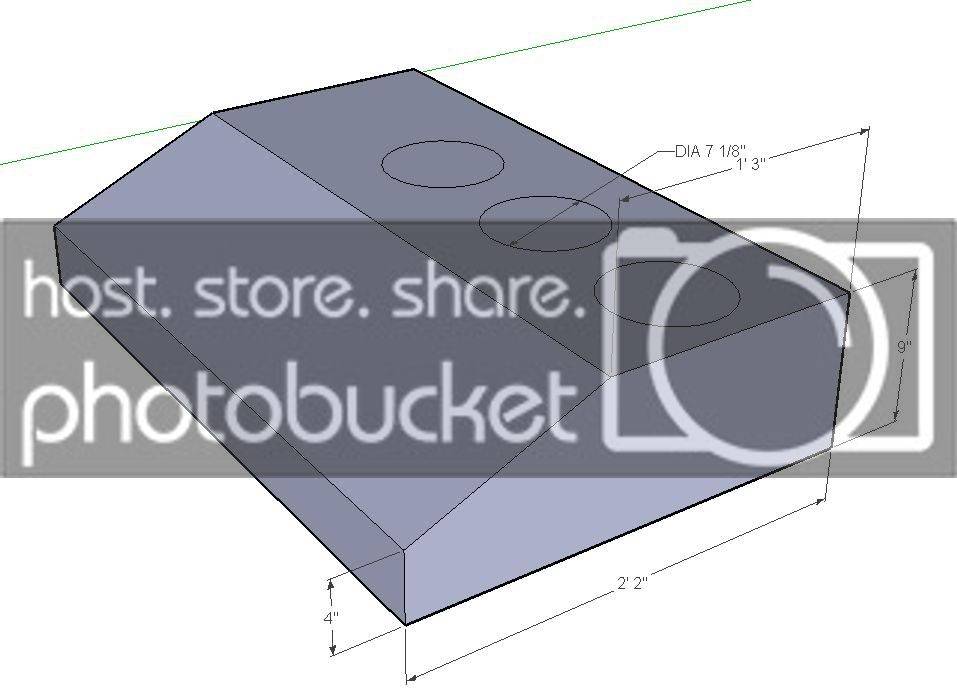

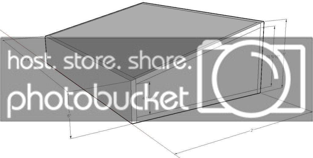

came up with two more designs i could run. the 8" h x 22" d x 40" w = 3 net.
if i did the math right - 3.7 net
still no clue on the ports
