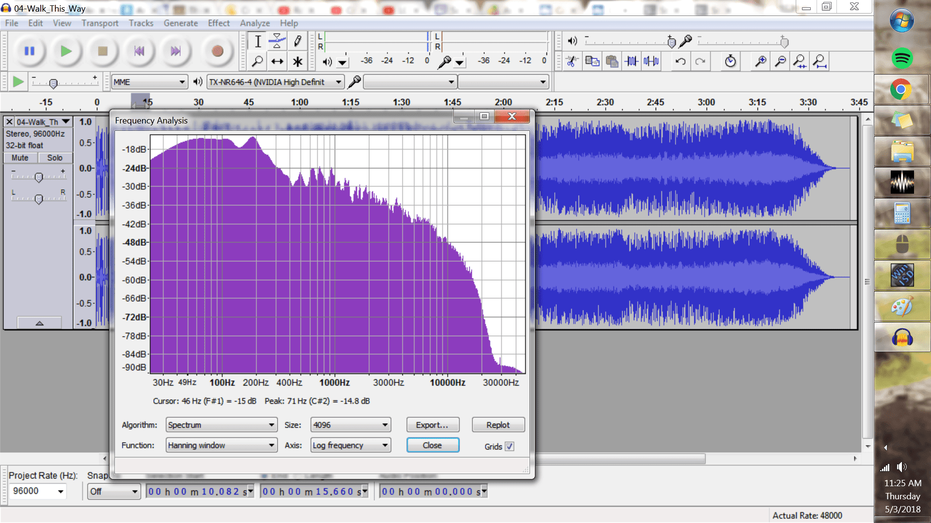

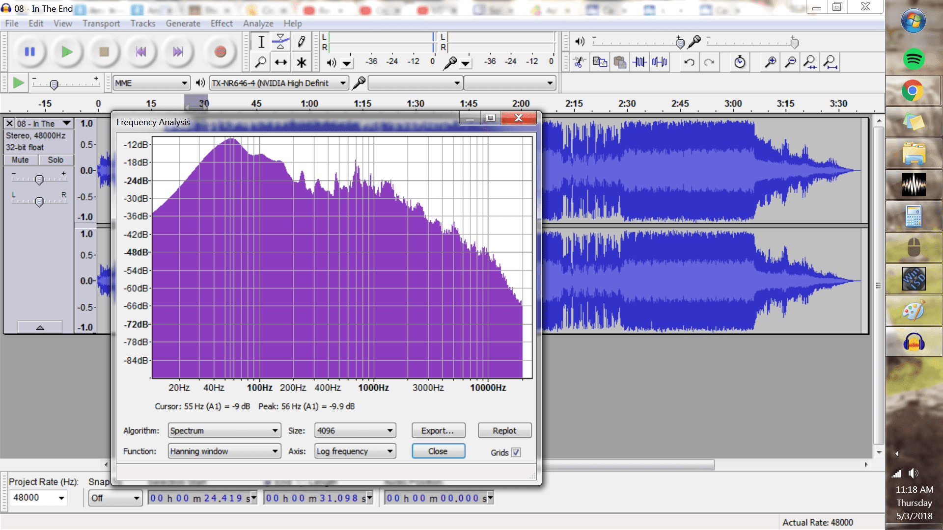

linkin park which normally has decent levels of bass for a rock song but its at a -9.5ish db level of bass recording at 55hz. Meaning if you used a 0 db test tone to set your gains, you are missing out on 9.5 dbs of possible output here, if you use a -5 db test tone to tune your setup, you miss out on 4.5 dbs of output, plain and simple
Now some Aerosmith good luck getting any bass from a hip hop tune with a -15 db at 46hz . This is why active gain setting aka your own personal adjustments of the sub level on the head unit is very important. I can literally still make hair fly with my bass with this song, it just requires a much different setting.

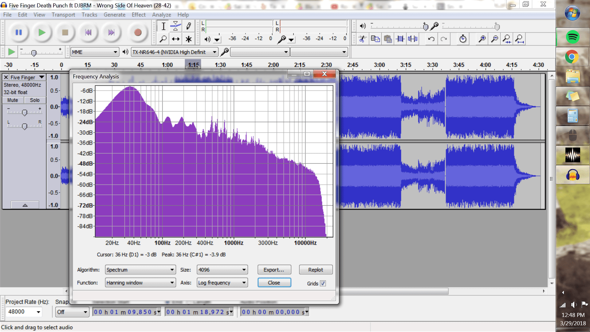

Now this shows -3 db at 36hz which means if I set the gain with a -10 db tone, I'll be clipping by 7 dbs worth which equates to quite a few clicks to my sub level. However if I set it with a 0 db test tone, i'll be losing out on -3 dbs worth of output. which is a notch or two down on the sub level. Literally proof of why setting gains with test tones is utterly beyond useless.
