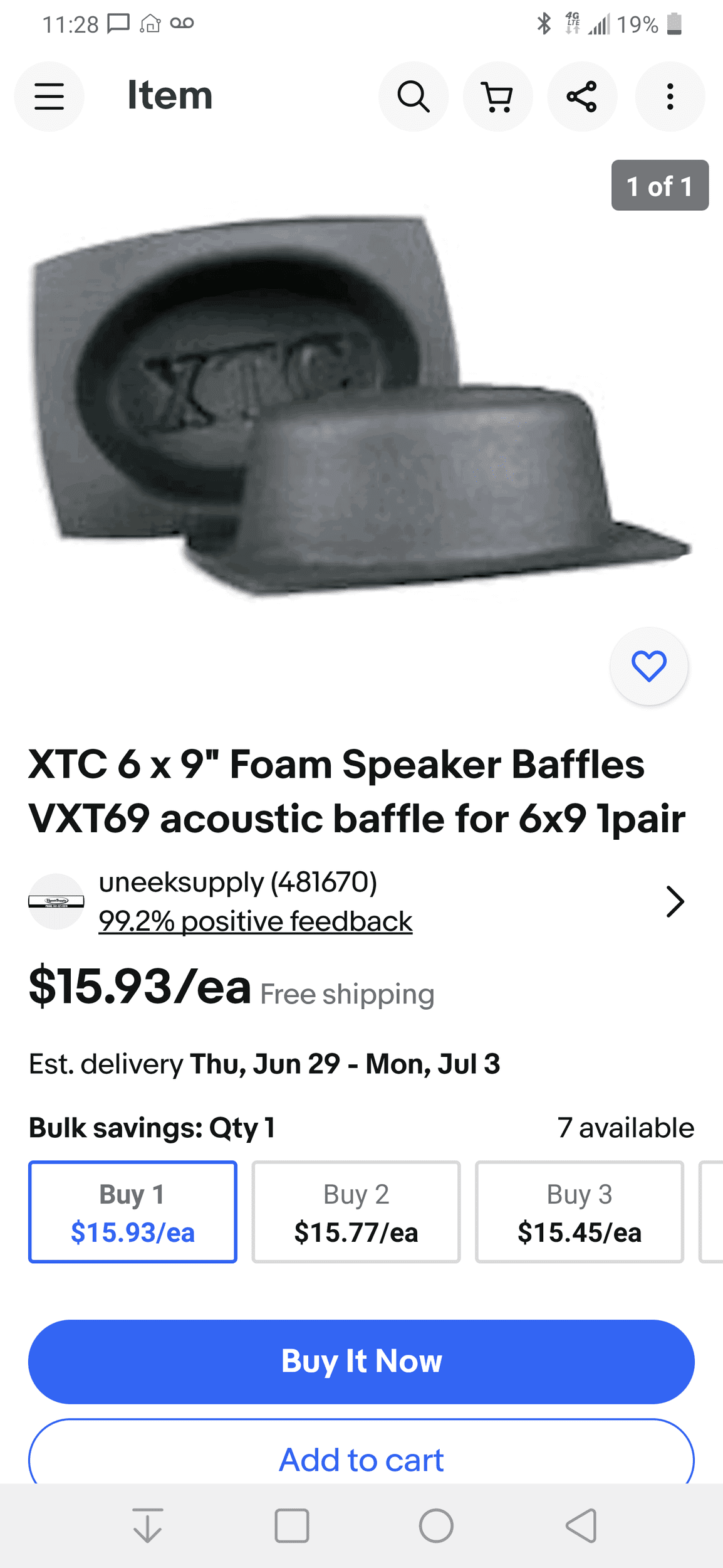

It does damage in the long run. The lead wires start oxidizing and can break off. A good product is a foam baffle that is basically a "cup" for the speakers. There are plastic ones as well, in case if you do not have alot of room in the cavity.

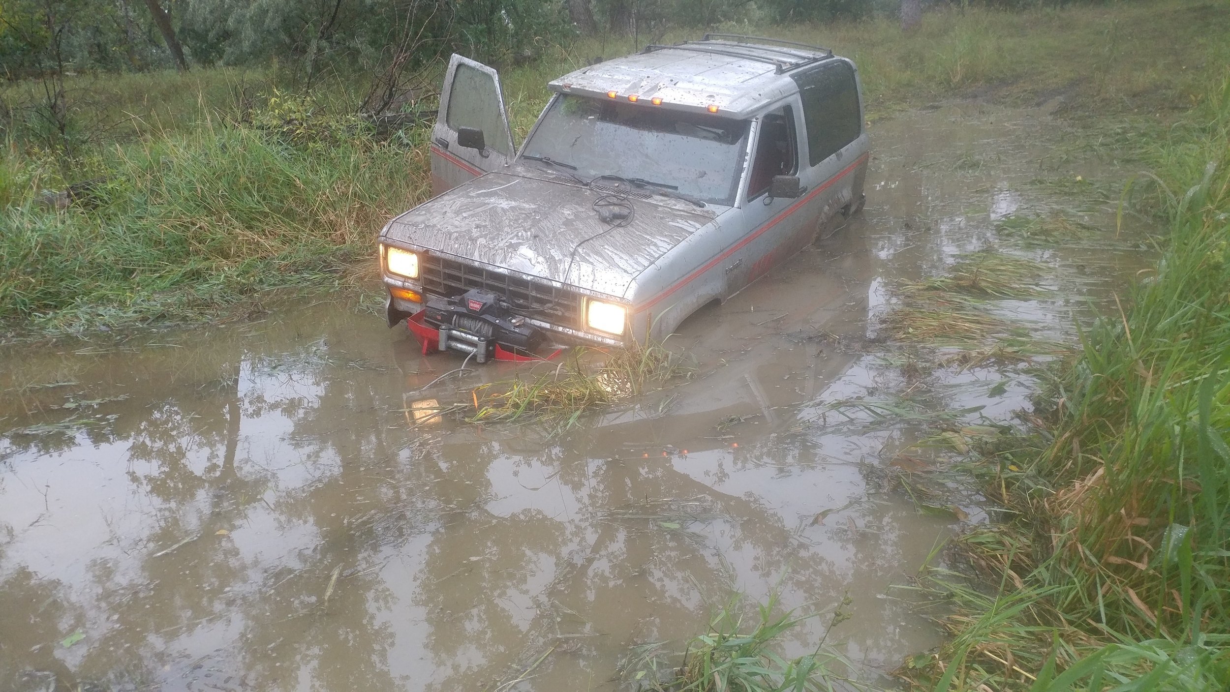

Let me put it this way: My 4x4 has had the same rear speakers for 13 years, and they have seen slightly more moisture than virtually any other vehicle with speakers will ever see.
