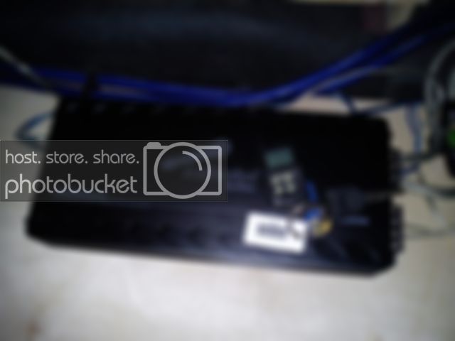

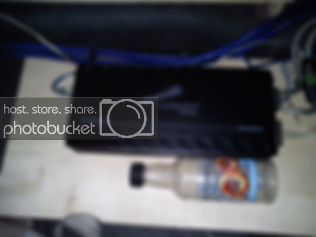

here are some factory pics of it:
Guts:
comparison pics:
