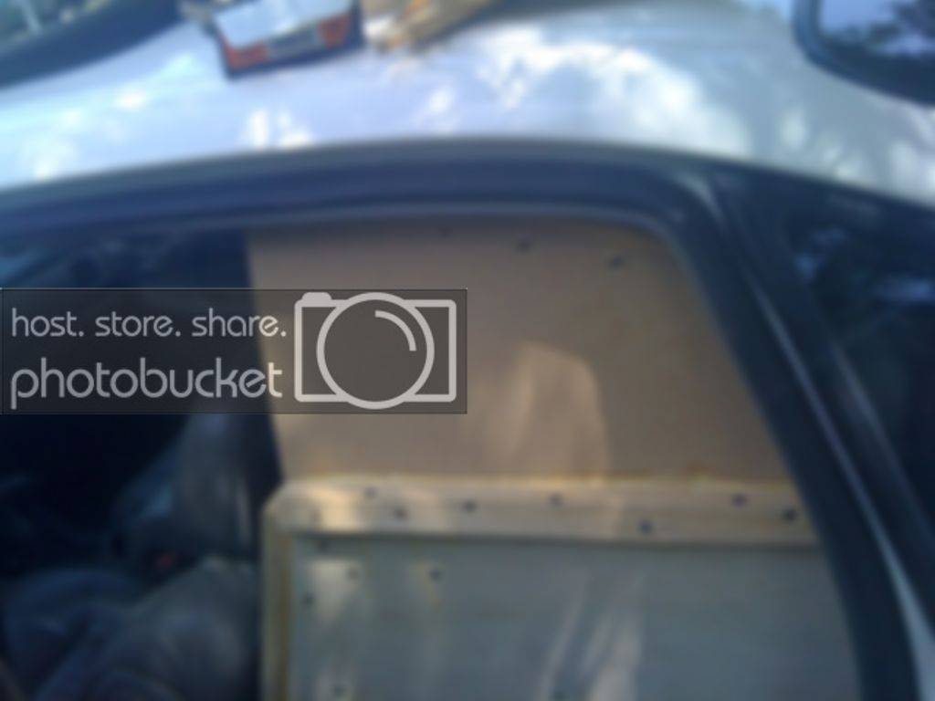

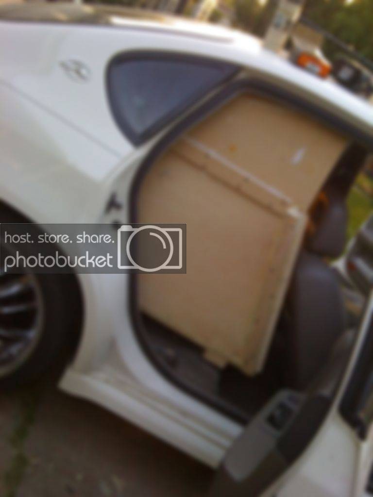

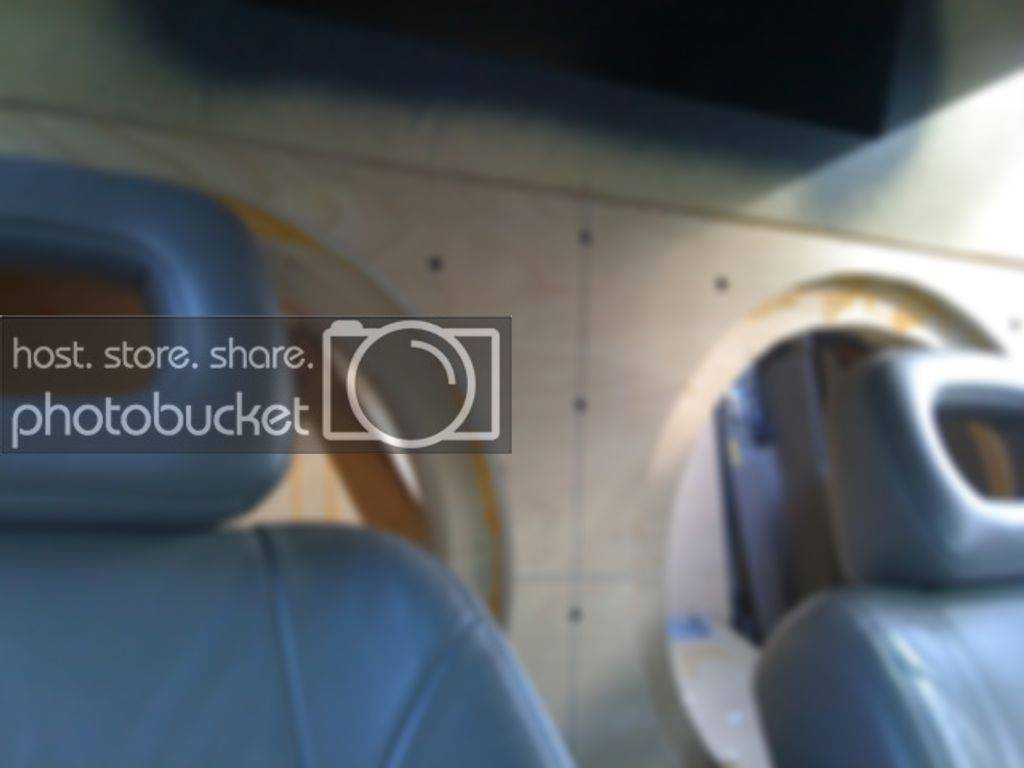

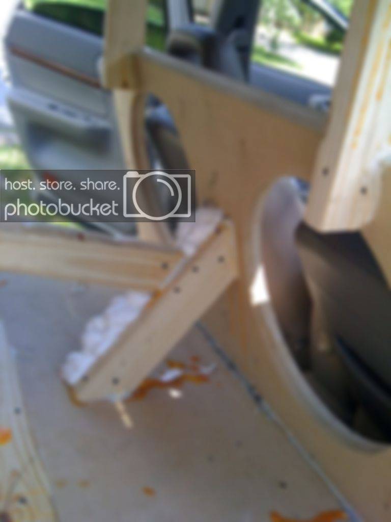

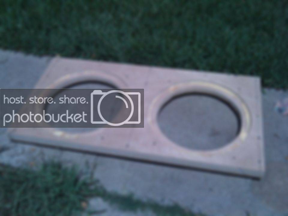

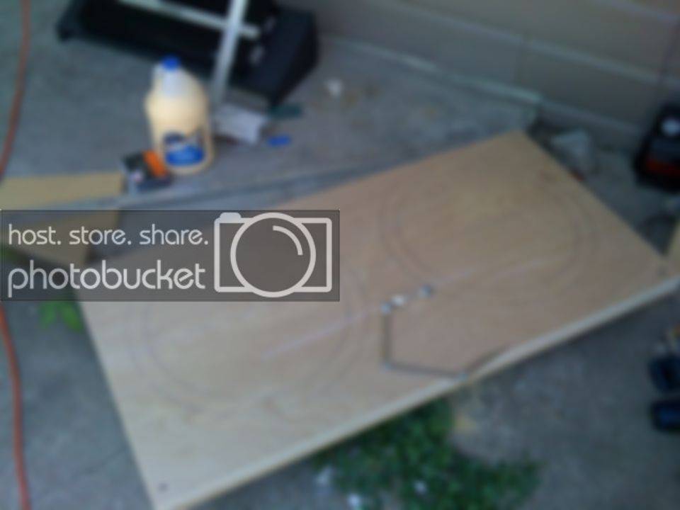

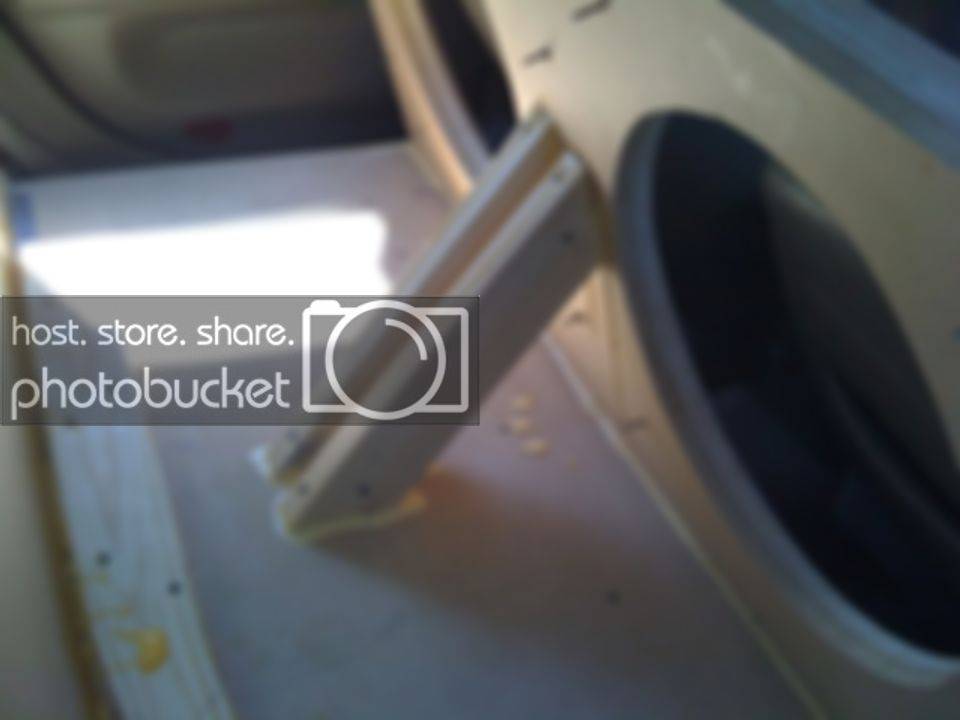

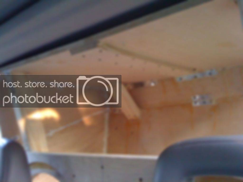

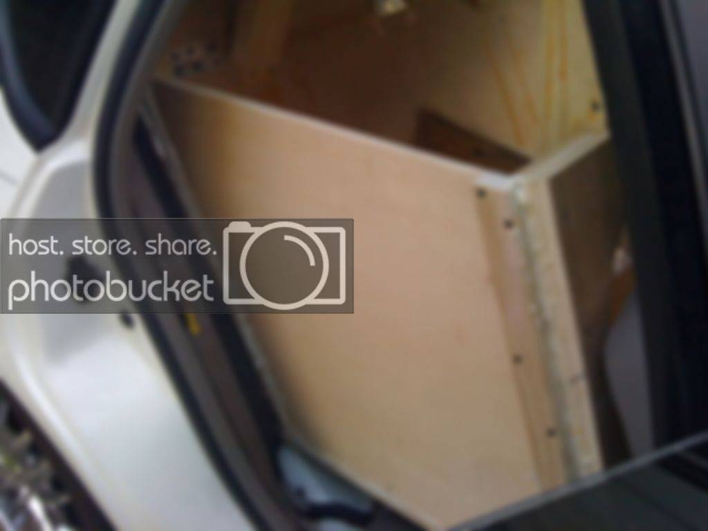

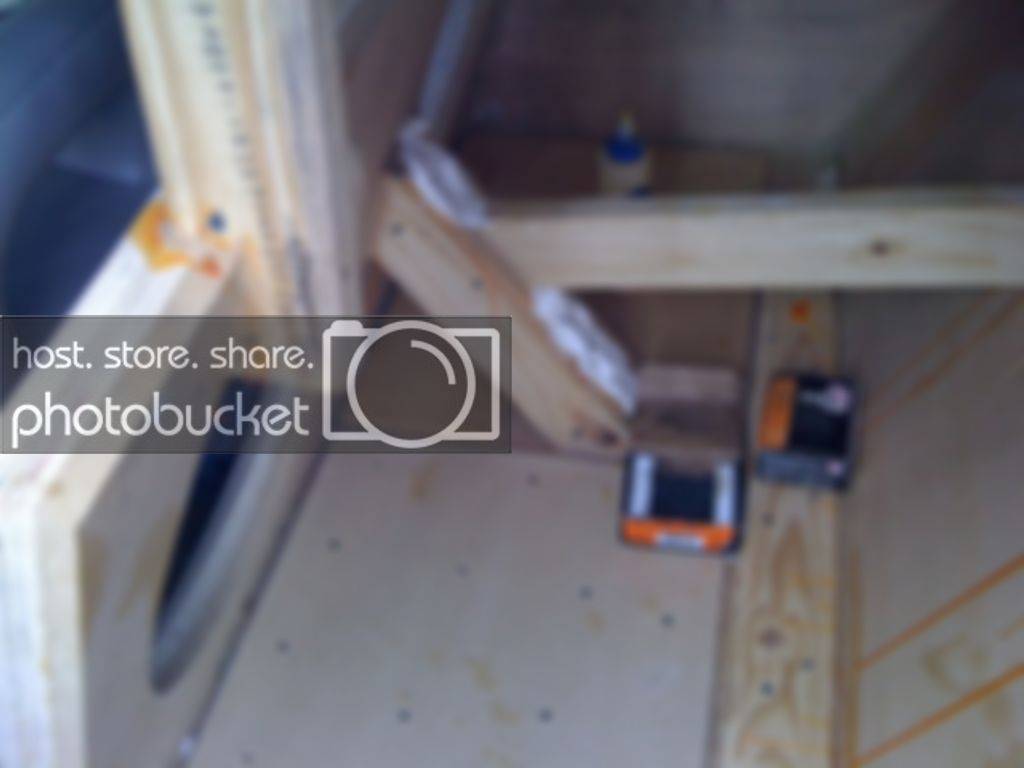

well the last thread got all messed up cause photobucket was ghey about their bandwidth so here is a new one with all the old pics and updated pics.
Still waiting on my 18's from ssackett.
40.1 should be done by next week.

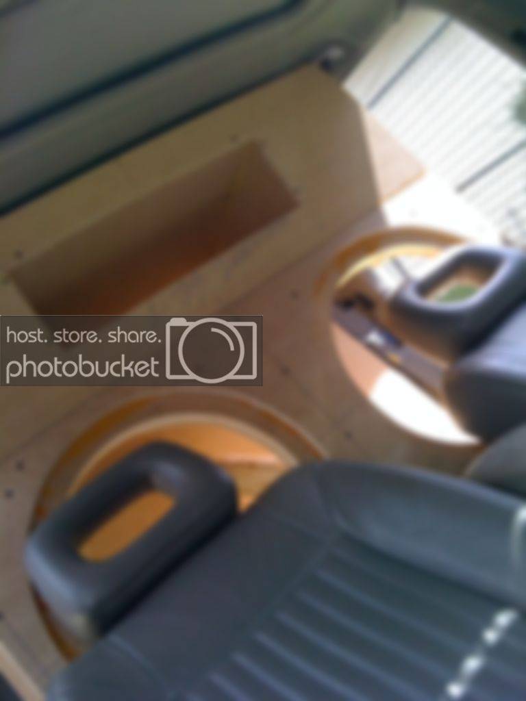

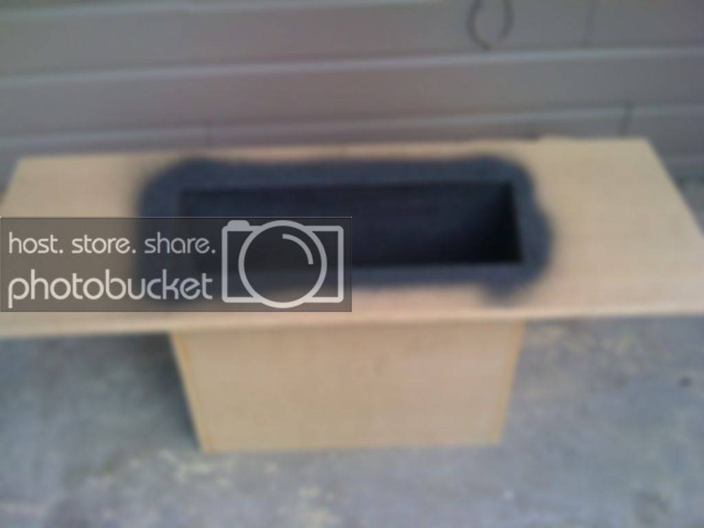

between now and then i'm going to be working on the port above the 18's. I've done some research and found out that PSP or "aero" ports are more efficient than a traditional slot port so i'm thinking of going with 4 6" PSP's instead of the slot.
that looks like such a pain in the *** to build. **** that, but im sure it will be louddddd. What will the tuning turn out to be when finished? or are you just gonna kinda wing it and see how it sounds?

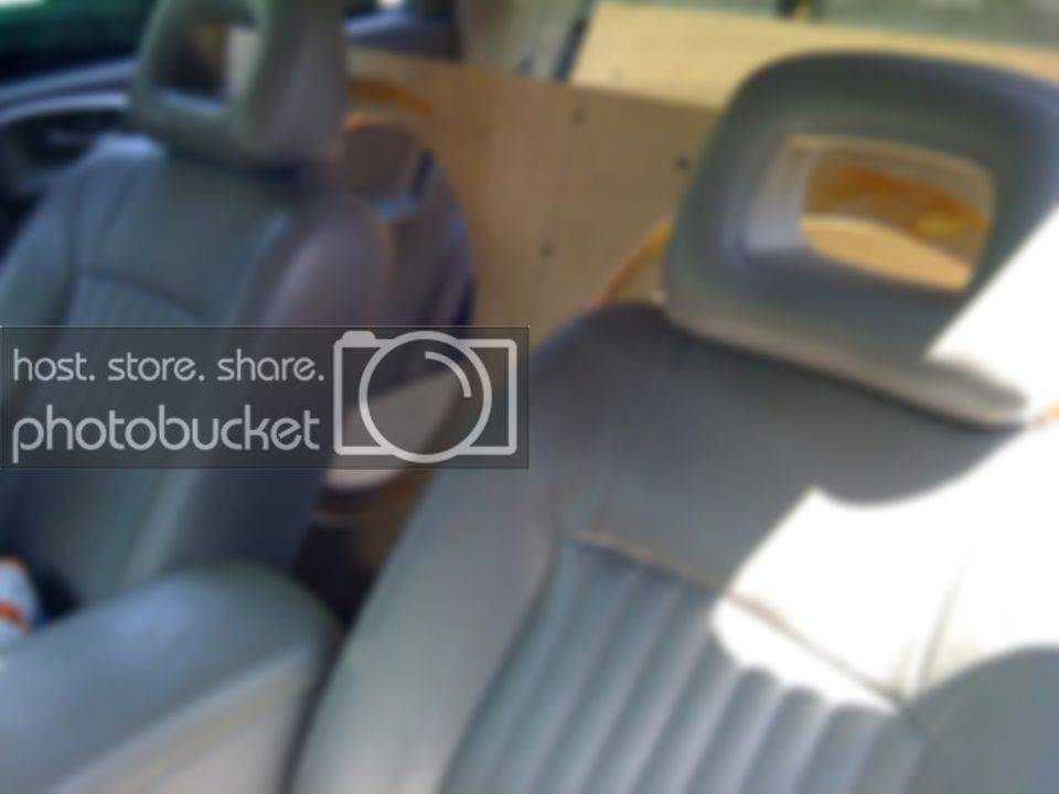

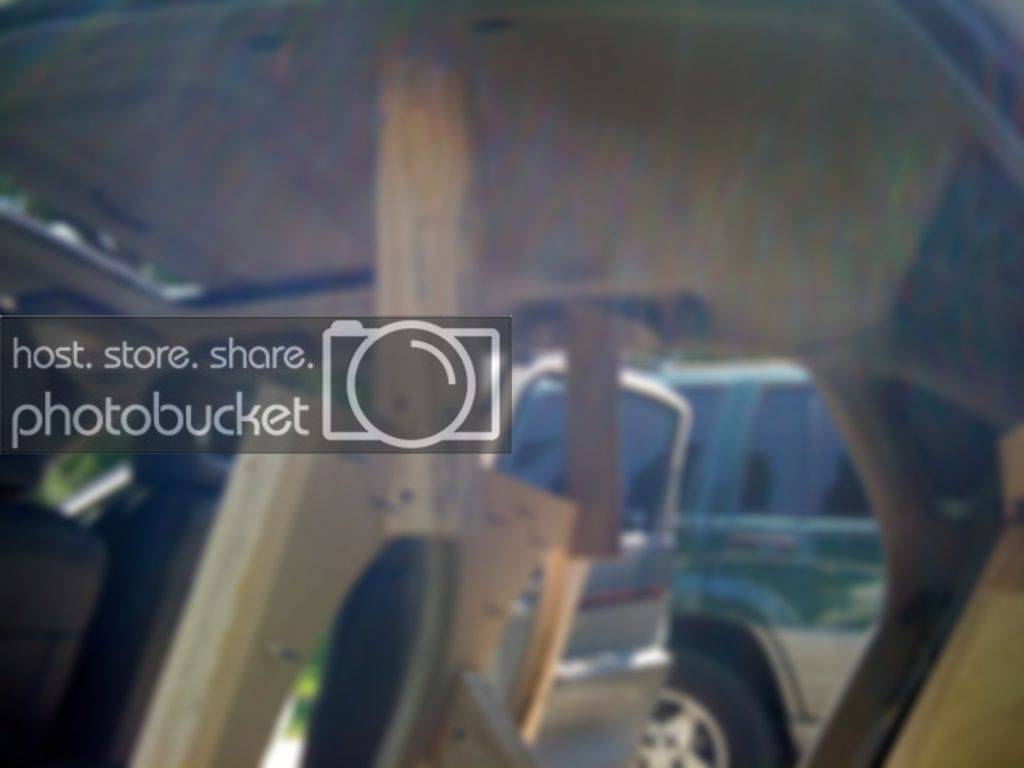

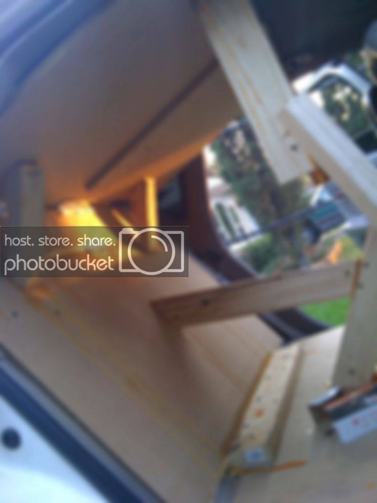

i'm thinking of putting some coil overs on the front just to level everything out. since i have the batts in front of the wall, there's not any weight in the trunk yet. and when im done the only thing that will be in the trunk is the IA 40.1 and the sundown 125.2
Looks good. What you plan on using to help with weight?
well i have a pretty good idea of the air volume and by using psp's site i'm going with 4 6" flared ports that will be 13" long that will give me a tuning of 35 hz. Hopefully

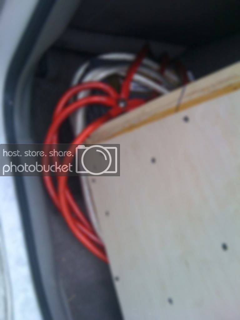

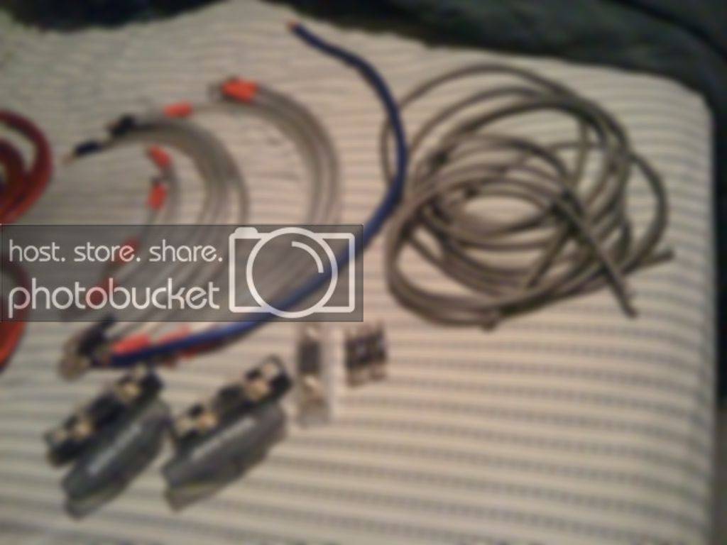

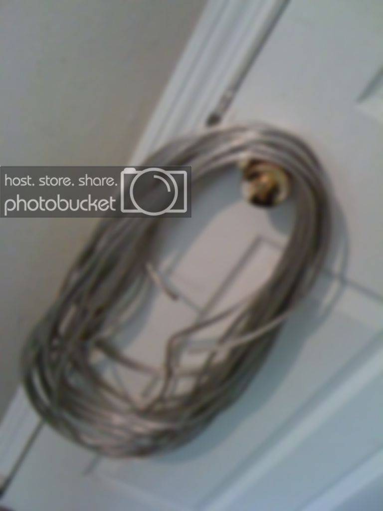

on a another subject, with only the 40.1 and the 125.2 will i see much voltage drop with my stock alt even having the 2 big *** C&D batts with 3 runs of + and -. I don't think I will but if it doesn't hold up I'll be ordering a DC power alt. we will see
