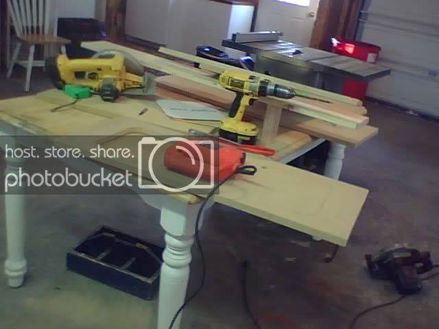

MDF cut out to proper measuerments for the entire box

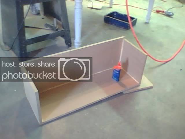

Starting to assemble

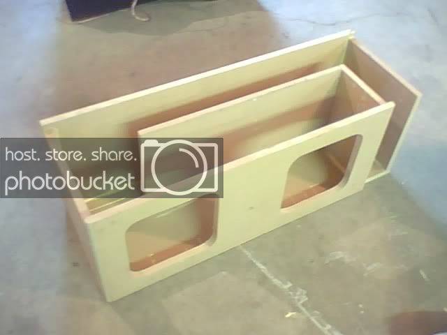

Cutting out the sub baffle, I also router'd the edge of the baffle to flow into the port, (what a nice work area.....)

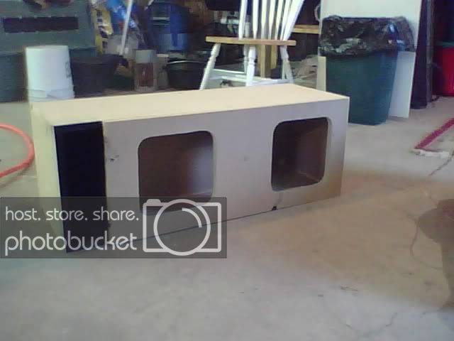

Adding the port

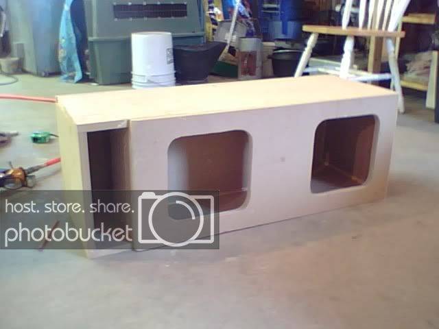

And the top
A little paint for the port, and now all i need is some carpet to finish it off.

Looks good, why did you recess the port?
just felt like it would be an interesting design
Have that same table in the frat house. Though admittedly yours is in much better shape, what with its 4 legs and all.
lol it was my parents old kitchen table then they bought a new one and there it is.... in my garage
won't the "recessed" port chanmge tuning atleast a little bit.
a little but nothing too out of proportion
^^^prolly not much at the most 2-3hz's
yea if that...
the tuning wont be changed really at all if it is at correct length. Now if it is 3/4" shorter because he decided to recess the port and not add to the back of the port then I can see the tuning changing...
Yea the tuning might change by half a hz if that.
