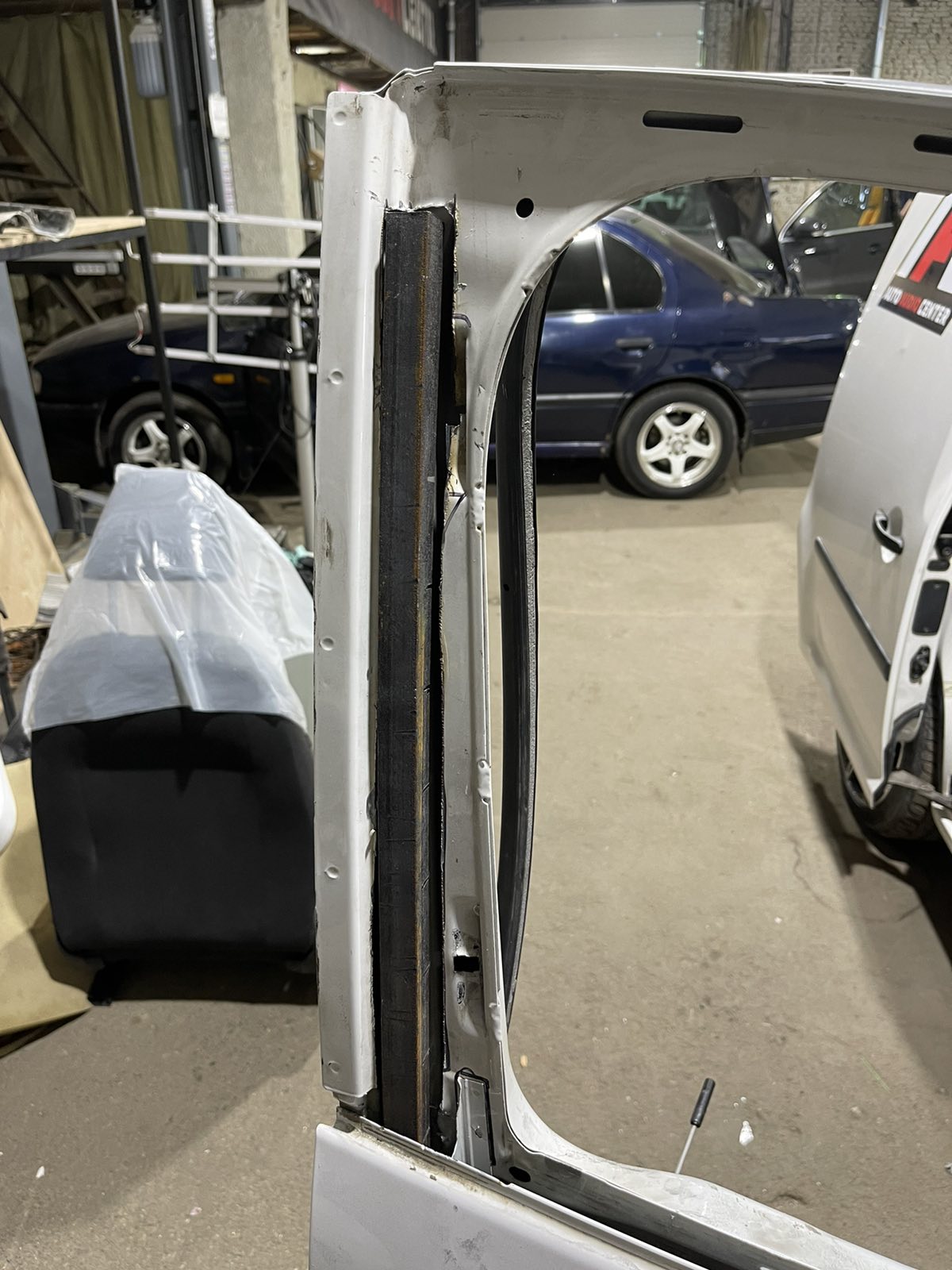

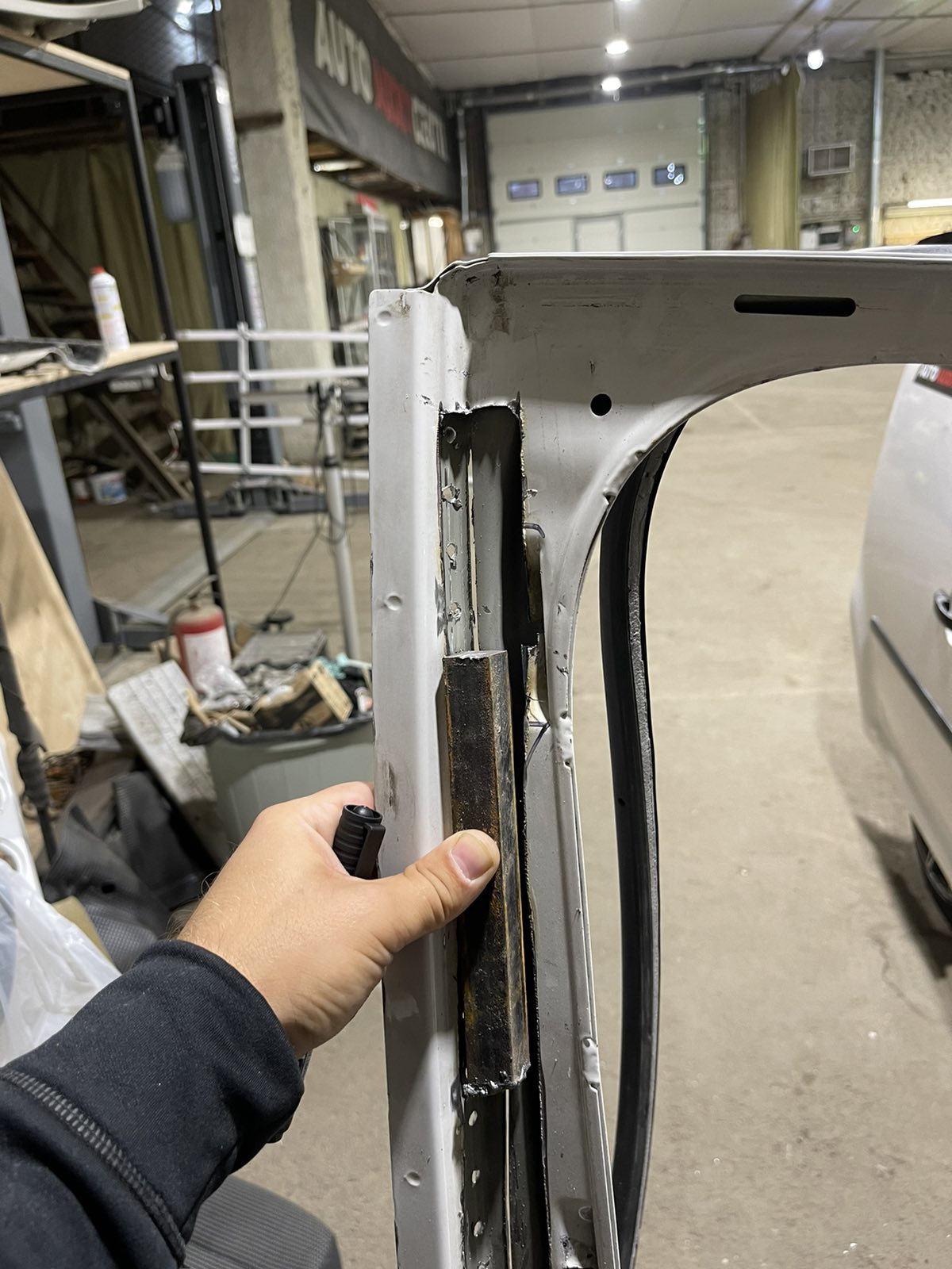

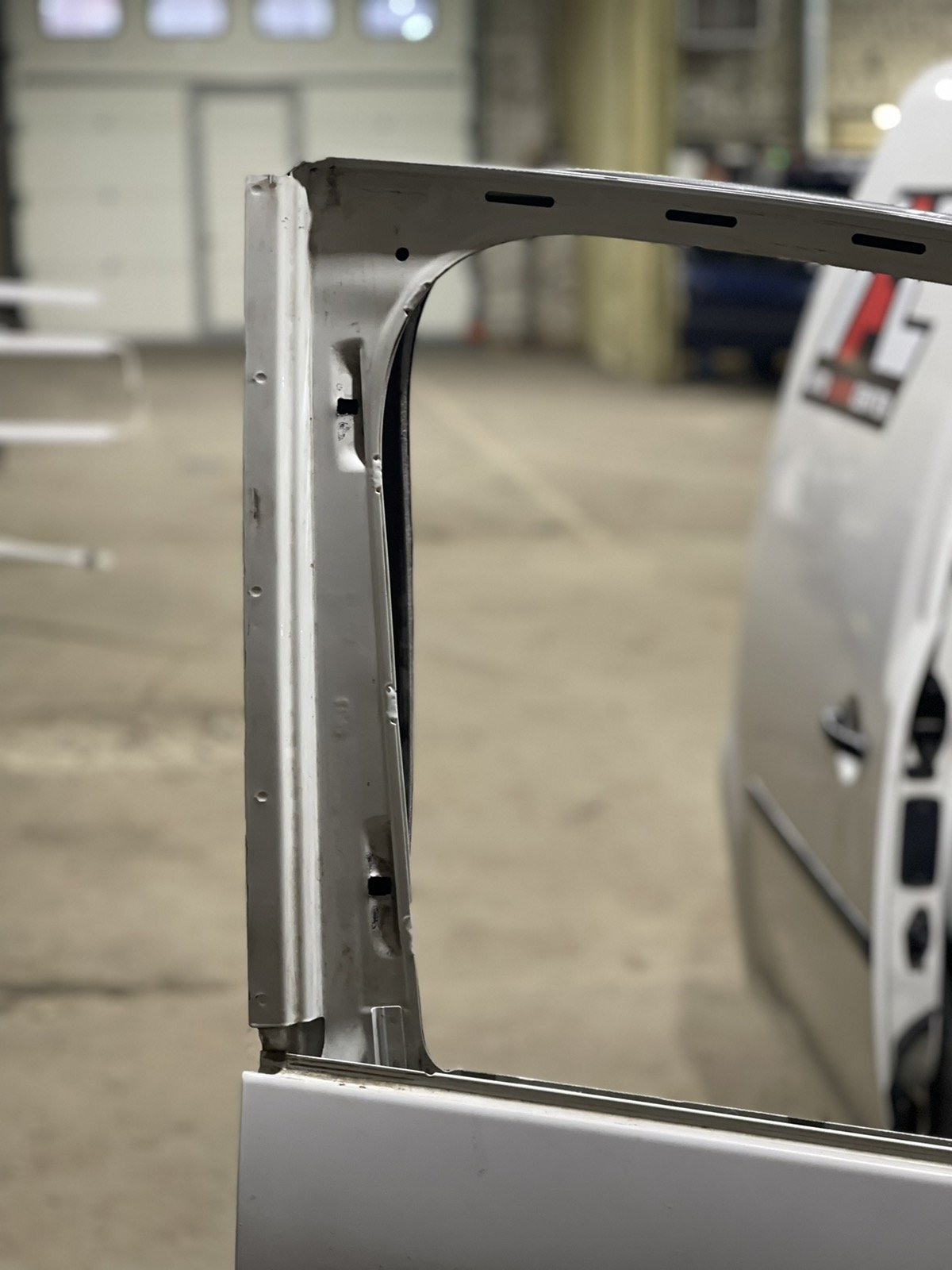

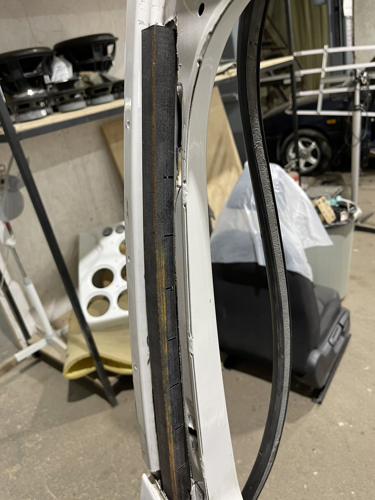

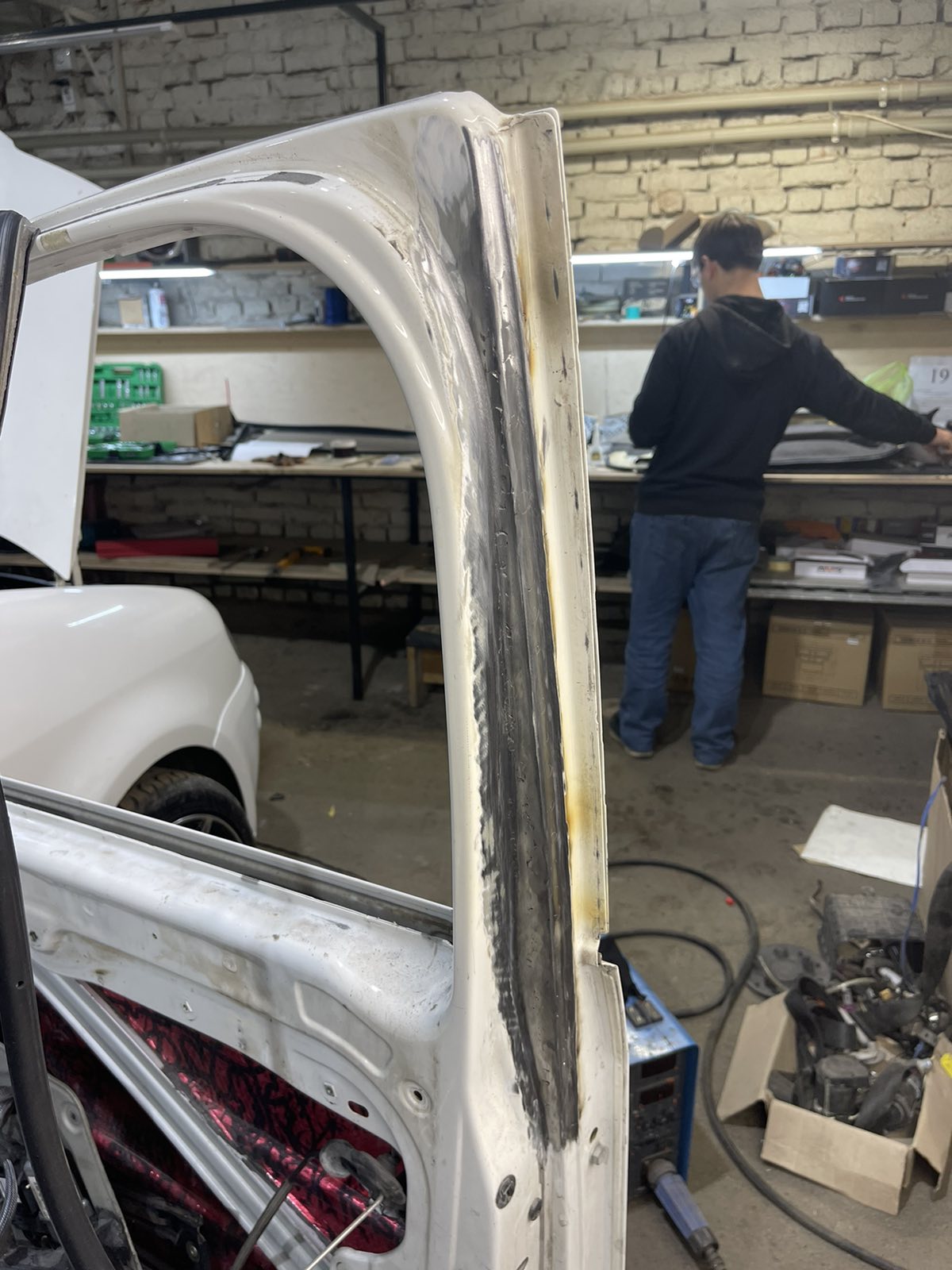

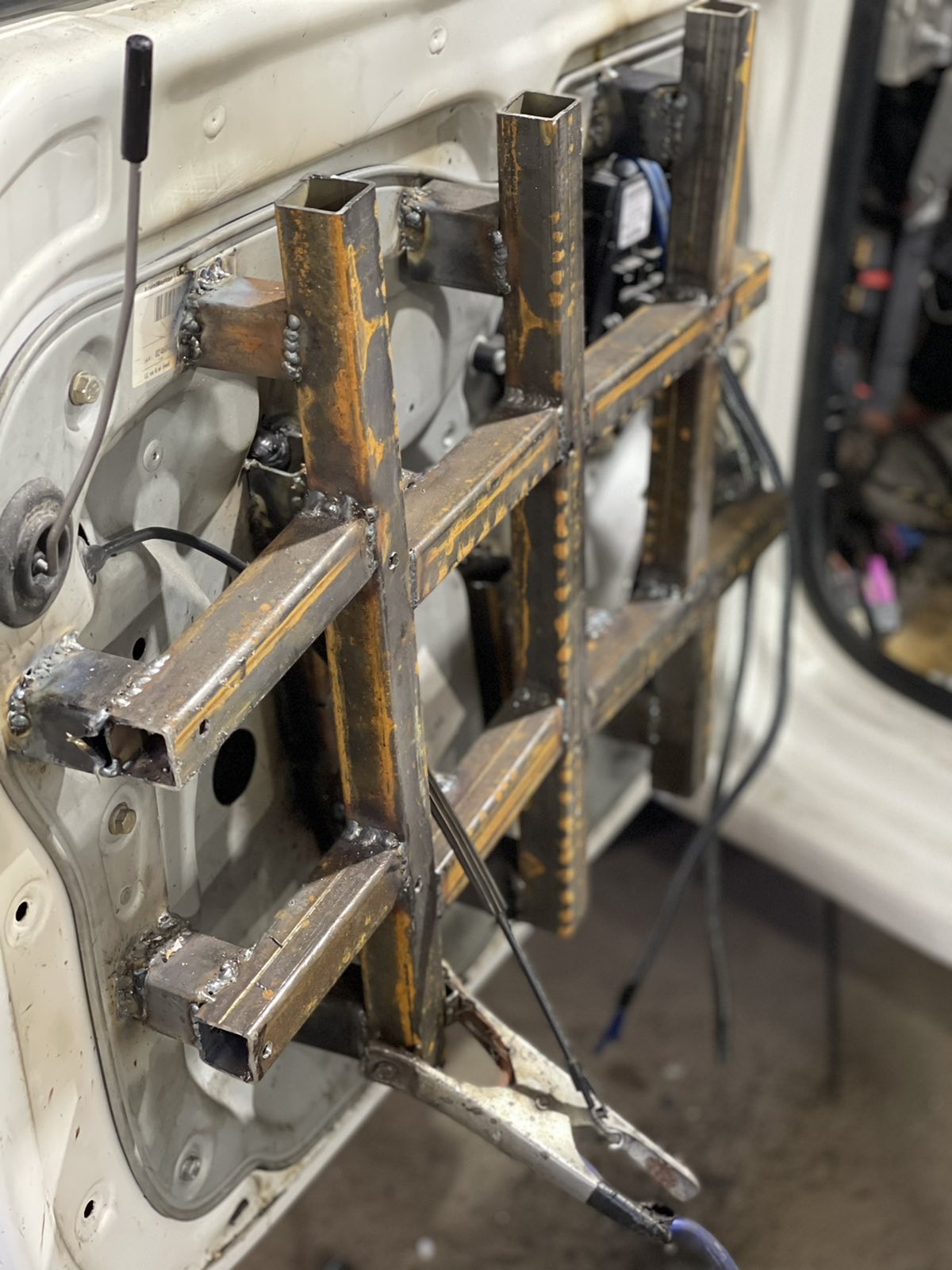

when measuring, the corner of the door moves very strongly. Therefore, I decided to strengthen the angle, a metal rod, which will be connected in all planes

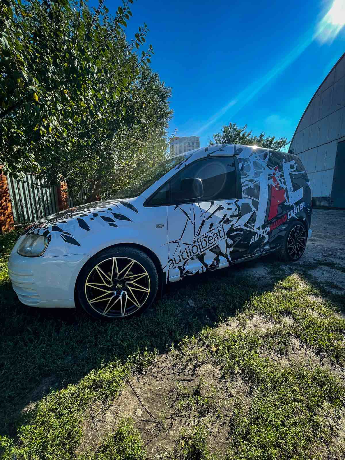

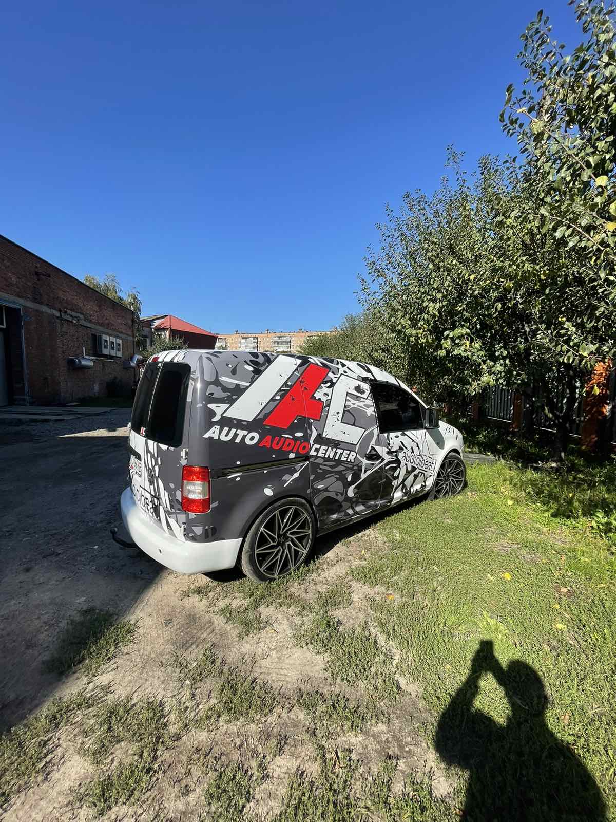

along with the internal work, the exterior of the machine was also updated

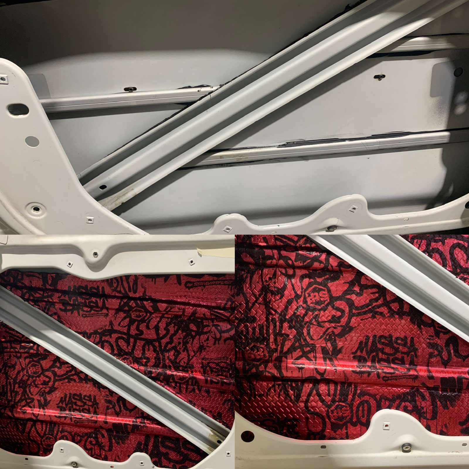

Have you done anything with the door skin? I was friends with a serious competitor who added mass/structure to the inside of the door skins. He recommended cutting strips of 1/4" steel and gluing them to the inside of the outer door skin. Much more effective than deadener. 3M makes an adhesive that is often used to hold unibody car panels together instead of spot welding. This works very nice. I was going to do this on my next wall build. I bought the adhesive for the last build, and never got around to doing it.
If the doors are still the issue, could bolt or weld the passenger door shut. I saw a suburban build with the passenger door bolted shut. People just had to come in the driver's door for demos.

дверь была усилена прутом, по возможности металлическим.

Ok, so it was reinforced around the edges, deadened on the outer skin, and there's a square steel bracket on the inner skin. Is there a specific class you compete in, where you have to meet a certain criteria? If it's not a daily driver, I really do think making the passenger door fused to the body would be the next step.
