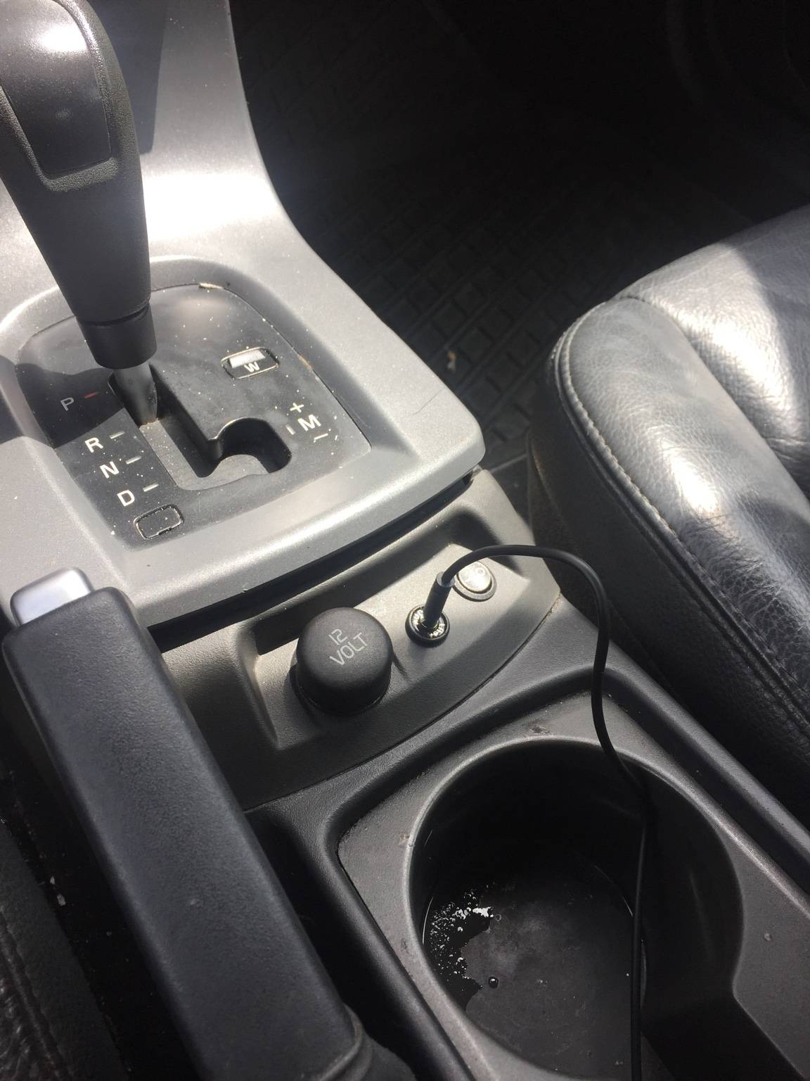

Just did this exact car on Saturday... ended up being SUPER easy.
Need the Metra EU10 and EU20 Antenna Adapters and the iSimple IS32 kit.
If you pull back the carpet on the drivers side of the center console there is a junction for the antennas, you will need to shave down the Metra Adapters but it works fine.
I also popped off the trim piece that the CIG lighter is attached to. That cig lighter is 12v ACC so you can tag power there. I also flush mounted the controls for the IS32 there as well. Ran the antenna wire down the center console to the antenna junction, stuff everything back under the trim panel for cig lighter and put it back together.
Maybe sounds more complicated than it was, took about 45 minutes, if I did another it would probably only take 20.
