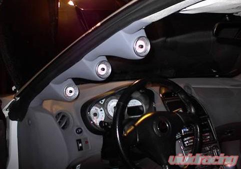

not my car, but basiccally where they'll go. except only two.
thinking tweeter bottom and mid up top, just gotta find a right side. ;/
you don't want a plastic mount for a mid. the mid requires a controlled, airtight airspace made from rigid materials. something you need fiberglass for when doing apillar mids. also, the lower range will be determined by the airspace - you still want an overall Q around .707.
