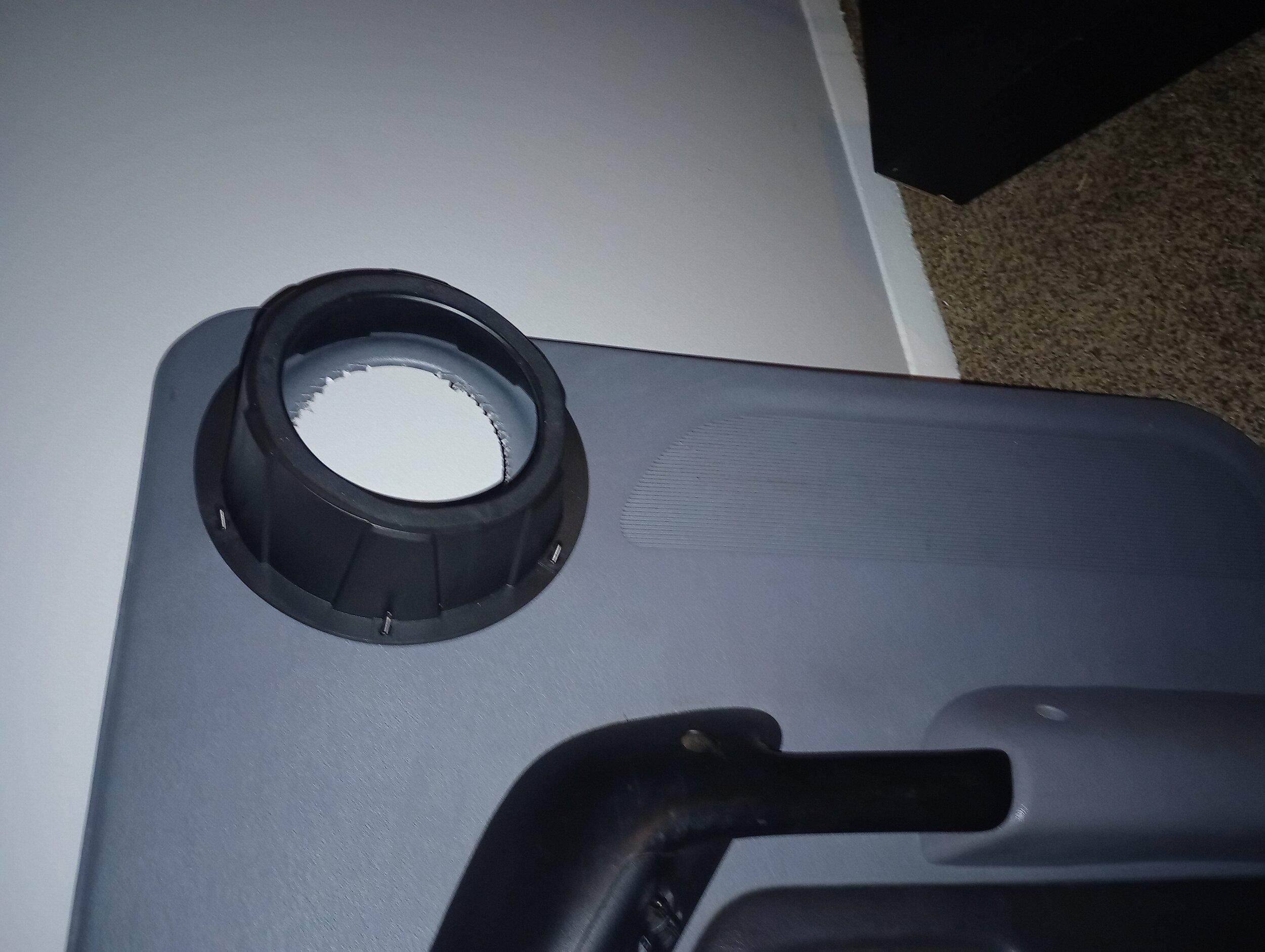

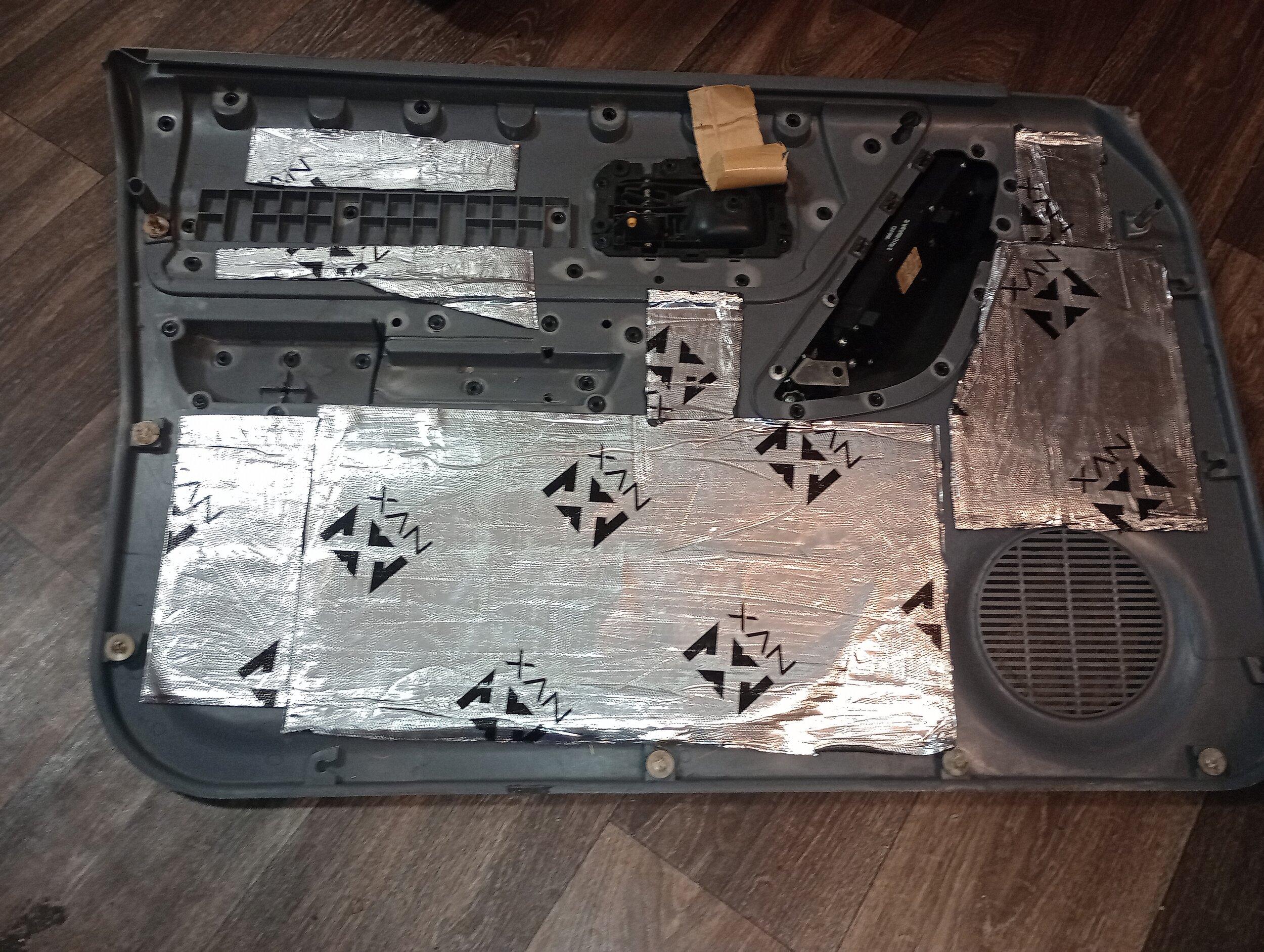

Picked up these nice cheap pods by Recoil Audio off Amazon for like $30. Used NVX 90 mil CLD on the door cards.

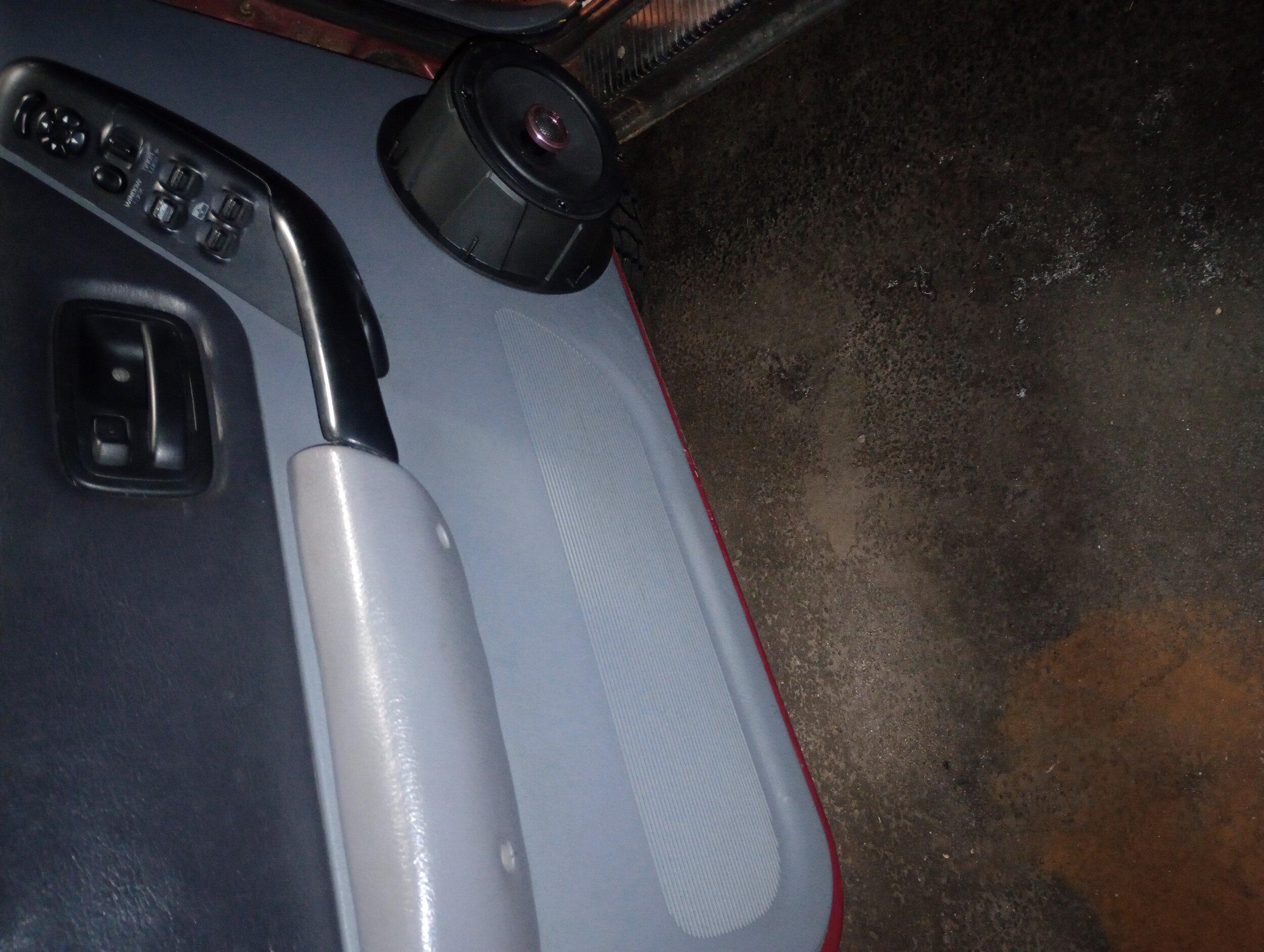

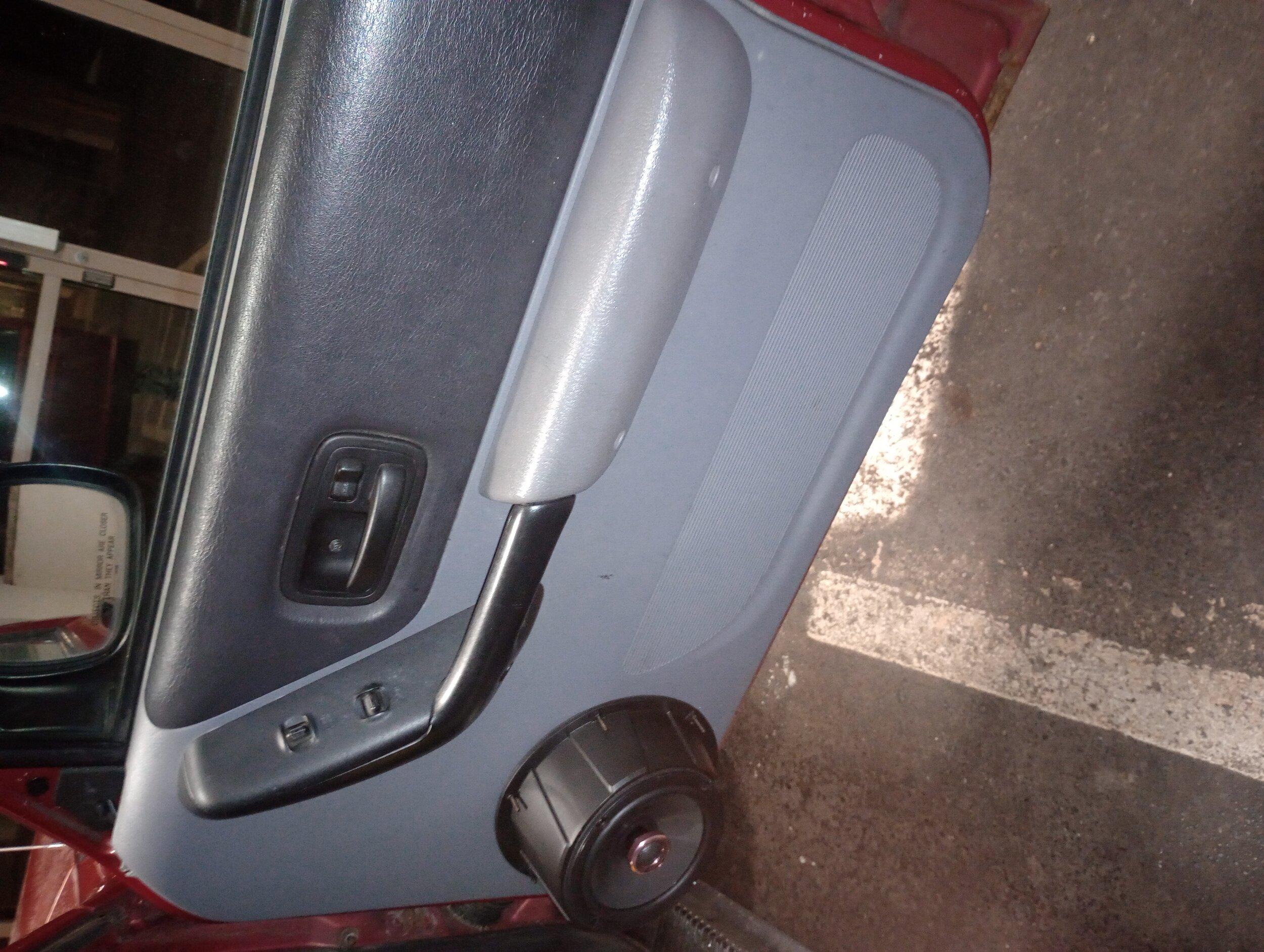

Then I cut out the grilles and screwed the pods over the hole where the grille was. Comes with a nice thick gasket on the bottom of the pod to seal it to the door card.
Installed on both sides in my 98 Cherokee
Speakers are Recoil Audio RAX (Rose Gold) Coaxial 6.5s. Jeeps of this era didn't have great options for aftermarket speakers. I believe Wranglers only had tiny speakers in the dash and Cherokees and Grand Cherokees door cutouts were tiny and had tiny mounting depths.
These are replacing a set of cheap infinity Primus 5 1/4 speakers. I've been having issues with both of them and I suspect the crossovers are cheap garbage and are breaking down
I went with coaxial this time because there is not any good place to mount a crossover behind the door cards or anywhere really in this Jeep (also these were laying around so no extra cost). I got angled pods to make the speakers not beam into my legs and the middle divider wall.
This helped a bit but what really helped was my headunit has a feature called "sound lift" (btw anyone know how this works?). I almost always leave all the extra settings off but this really helped. It sounded like the sound stage I got from my components with the tweets in the sail panels.
Overall I'm happy with it and they sound good and are loud on just HU power. I have a recoil 80.4 ready to throw on there too so I'm sure they'll sound even better. If you need a cheap way to install bigger speakers, this was def easy. Hardest part was scraping the almost 30 year old glue off the door card that held on the factory sound insulation so I could roll on the CLD.

I had a Cherokee, you don't need that pod. A 3/4" MDF spacer on the door panel is enough to clear a ~3" deep speaker and looks much better. I stuffed ~1/2 - 1" polyfil batting behind to absorb the backwave and road noise. It's a nice upgrade for a couple bucks.

I actually have a set of MDF rings but I figured I tried this instead. The pods were cheap enough. What I was worried about with the MDF rings is that are not angled and even with these ones I still have to fade to the drivers side about 40% cause it's so off axis compared to the passenger side.
I like the way these sound and I don't think they look that bad. Only thing I would change is shorter screws. I had to use the screws with the threaded side going into the cabin. Might have to take a bolt cutter to them and then sound it down for a cleaner look
You should have to fade to driver's side, that's normal in car audio. Alot of the typical issues you have in car audio get exaggerated in the old Jeep Cherokees. It's a hard vehicle to get sounding good and dumped tons of money into Cherokee trying improve the sound.

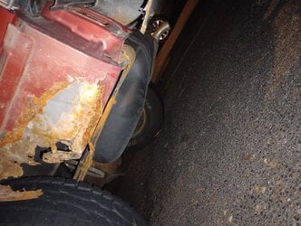

Yea I don't have a whole lot in this one. I was gonna add CLD to the floor boards but I started pulling up the carpet in the trunk area and apparently my rear body corners on both sides were crumbling away under the fender flares and the truck floor panel was very moist.

It's a 98. Looking to replace it tho. Ive had this Jeep for a year and half under the impression that there was only a few rust spots that need patched (I've been under this jeep many times to do work) but I was taking off the flares and bumper caps Sunday cause they are ugly and lo and behold I found those massive holes. They only became visible when I pulled the pieces off or I wouldn't have bought it if I'd known it was this bad. Very upset cause I don't have the money/time/patience/tools to fix all that.
