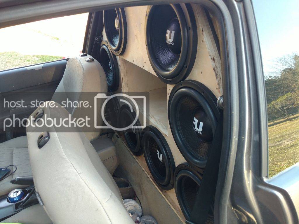

Not sure what size box FU sub need but worth looking at.. also whats the width and length of port on your box? never mind i found it., u know that box is tuned to like 46 hz after sub disp right?
