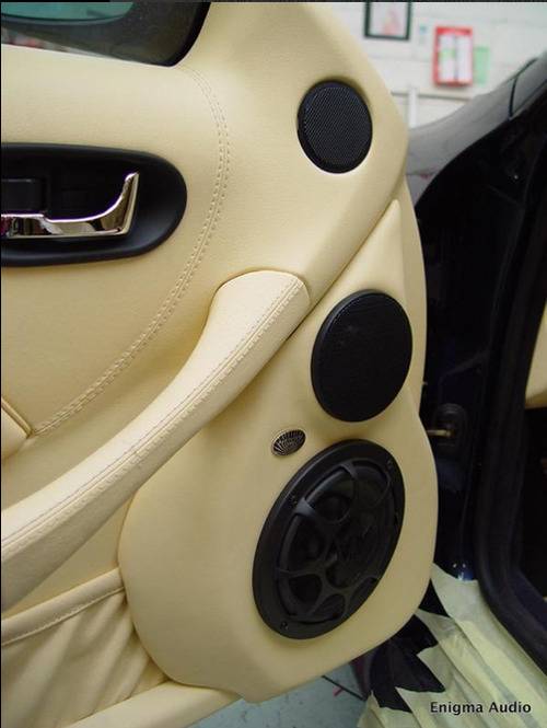

Mainly 3 way active front is tweeter, a 3 or 4 inch midrange, 6.5 or 8" midbass midbass is the musical region where snares, kick drums and deeper male vocals take care of. Midrange is the vocals. tweeters is the high hats, cymbals and airiness to the vocals.
here's a picture

If you want the best sound possible, forget about running rears, rears only destroy your sound stage stage and are utterly and completely useless. In competition level installs, you'll never see rears. Basic reasoning is you dont go to a concert and face your back towards the band/artist, you face them. A proper 3 way active is what i showed you. everything up in front, no exeptions. Mids and tweets are aligned close to eachother to keep things in phase, midbass is needed up front so when drums play, you can feel it sweeping across the dash. If you have anything behind you, it'll be a mess.
