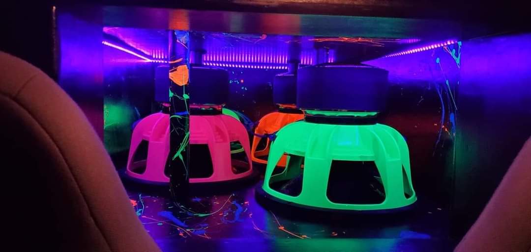

Here's a few current pics showing the new paint job and the 4 8" mid bass drivers.
Cant find a pic of the 8's will add them later
