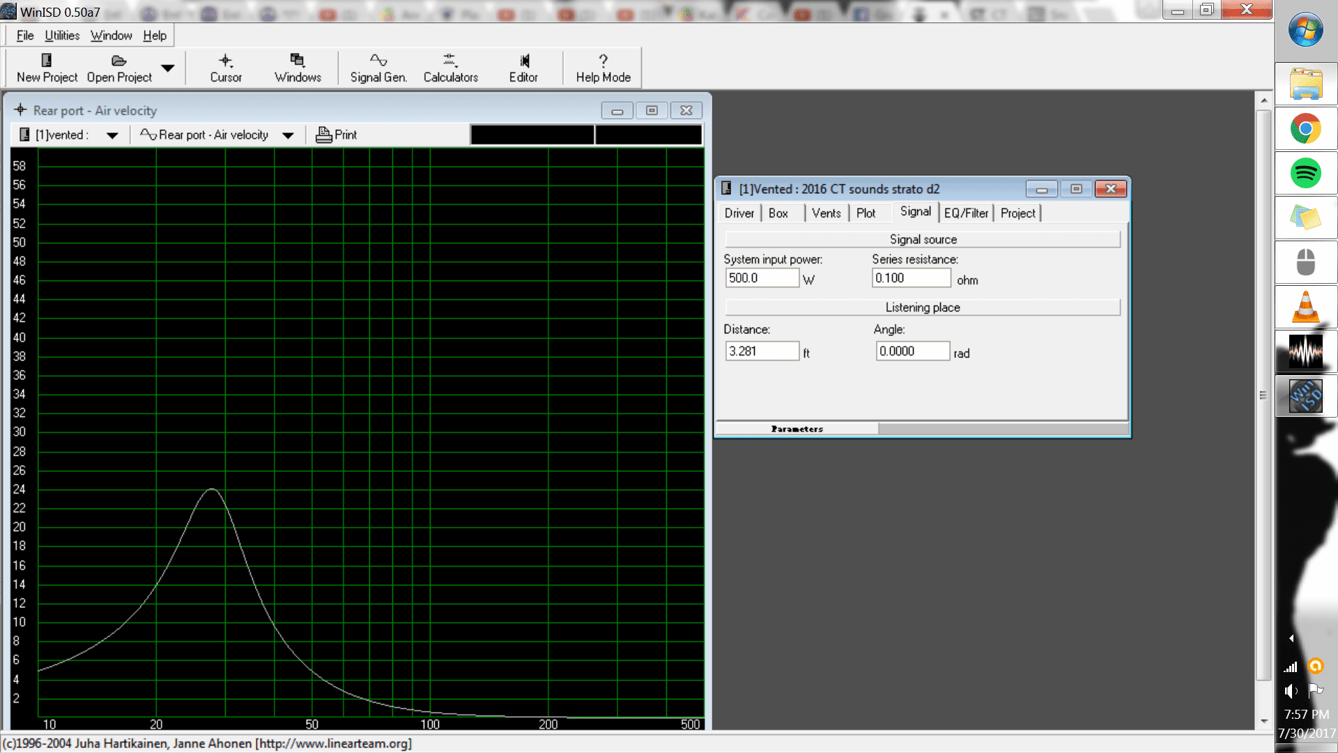

This is how the 2016 strato 12 model. on 500 watts.
i listed as 600 in the signal system power section but actually i think it's just not showing up cause when i move "line" to check it shows 114db at 40hz, i was just can't see it..
you didnt input any power. think you really need to work up on your winisd skills.
omg how u get that flat? so is that air vel ok how high can it be? cause mine are showing high now that i input power, obviously my box is smaller but tuned higher so shorter port but also 1.5" wide not 2
well seeing your graph thats definitely screwy and completely wrong lmao.

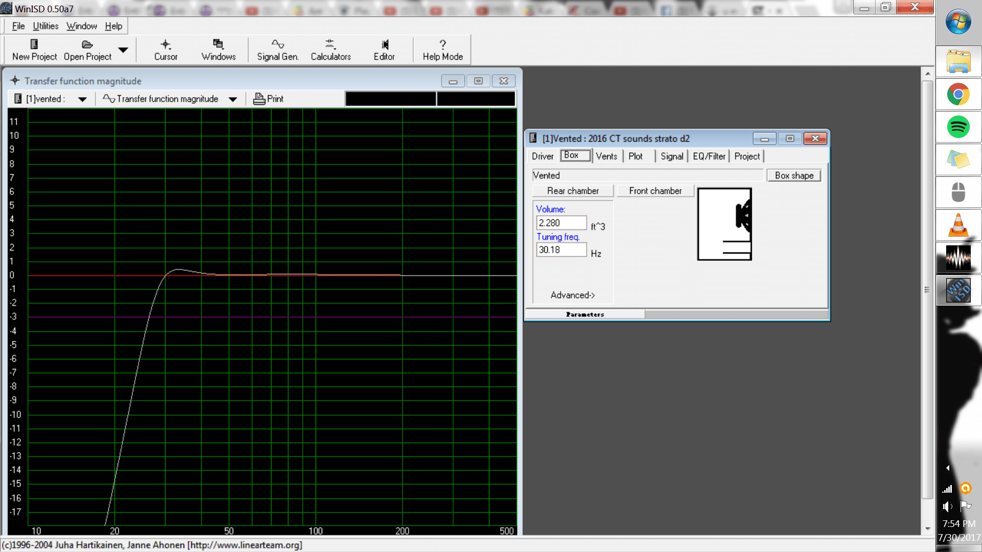

Please learn how to enter in values properly and in the right order along with not adding in random numbers not provided by the manufacturer. If the mms and BL is not listed, dont enter it in!!!! its that simple.
Skip to 4:40 enter it in exactly how he enters it.
you arent gonna get any SQ flat sounding results with a small box. Thats the automatically generated box specs determined best for fidelity by winisd. I didnt do anything. it automatically determined 2.25 cubes at 30hz was the flattest possible sounding box.
i don't even see where to enter mms in parameters

Well i watched it 3 times and every time i input specs save it and try to open it on new projects i get error message about floating point or something., so when i'm ready to get a box made i guess i'll have to pay someone for a design cause i can't do it.. port air vel is showing like 74ft/ps cause of small port so that *****..
