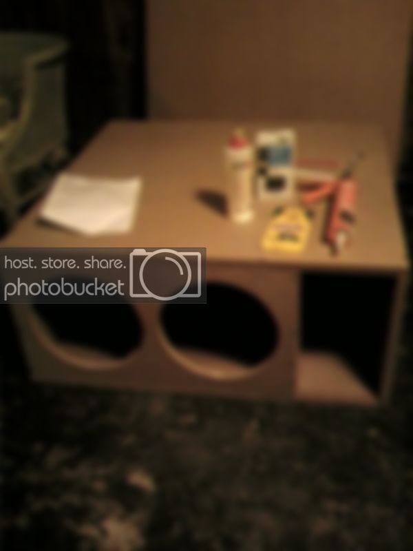

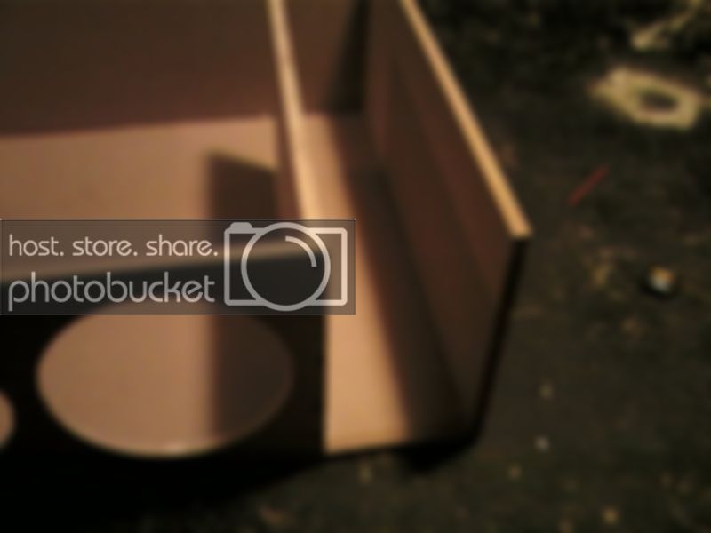

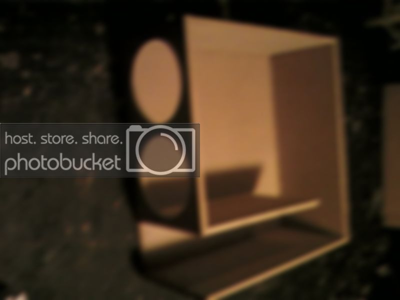

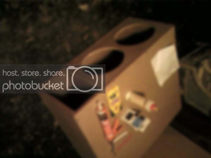

here's a box i did without my parent finding out......
what do you guys think?
sorry about the quality, coming from a 1.3meg phone....
Nice job- the port will work fine. Size doesn't matter really as long as a port is the correct length- just adjusts the tightness of the tuning frequency. Take for instance a 50 sq in port tuned to 34hz vs a 100 sq in port tuned to 34 hz. The larger the port, the more narrow bandwidth the port resonantes at. Smaller port- broader bandwidth. Meaning, the larger port will tend to resonate at very close to its tuning frequency and at higher output.
Not to mention larger ports avoid chuffing and the like.
