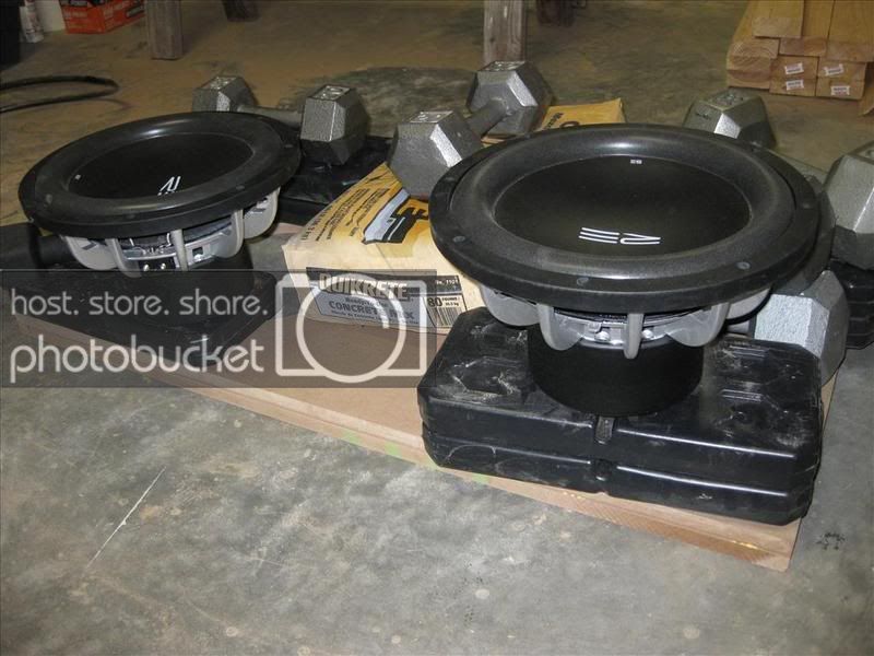

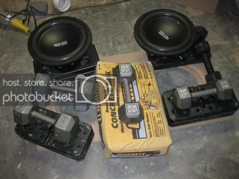

Two SE12s, AQ in an Escape.
nice install, gosh i want some SE's!
Thanks man. Ya the SEs are sweet, just don't put anything less than 800 on one. Mines got 600ish a piece and they're begging for more, even in a almost 6 cube box.

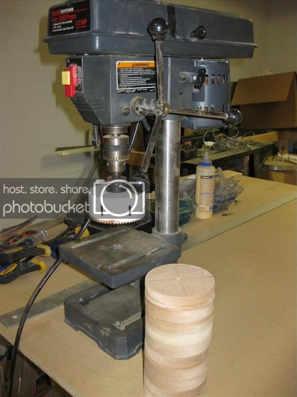

Not much done tonight. I have the hole saw, but i'm gonna borrow my neighbors drill press and use that with the saw to keep everything straight as I can. I'll hopefully have a good bit to show tomorrow.

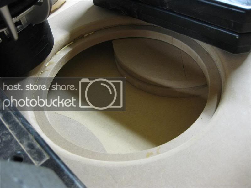

Tonight though I rounded over the top baffle and glued the baffle together. I don't have any good clamps, so its under a lot of pressure right now lol. I put some screws in the bottom as well just in case. I also figured which lengths would be what for my ports.

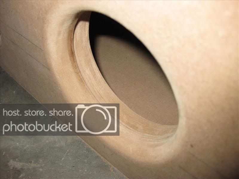

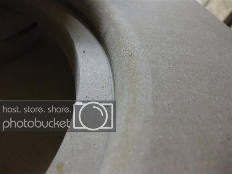

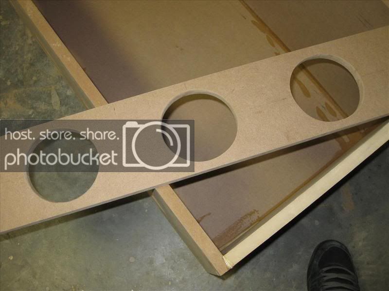

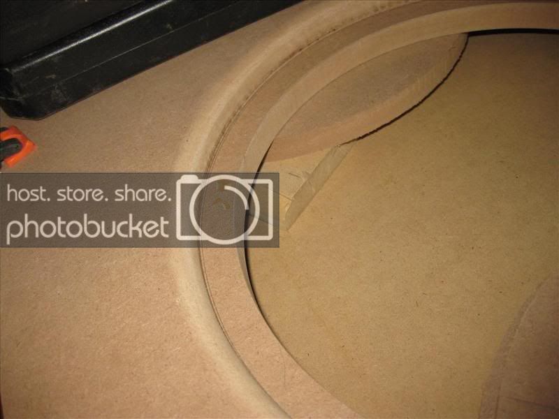

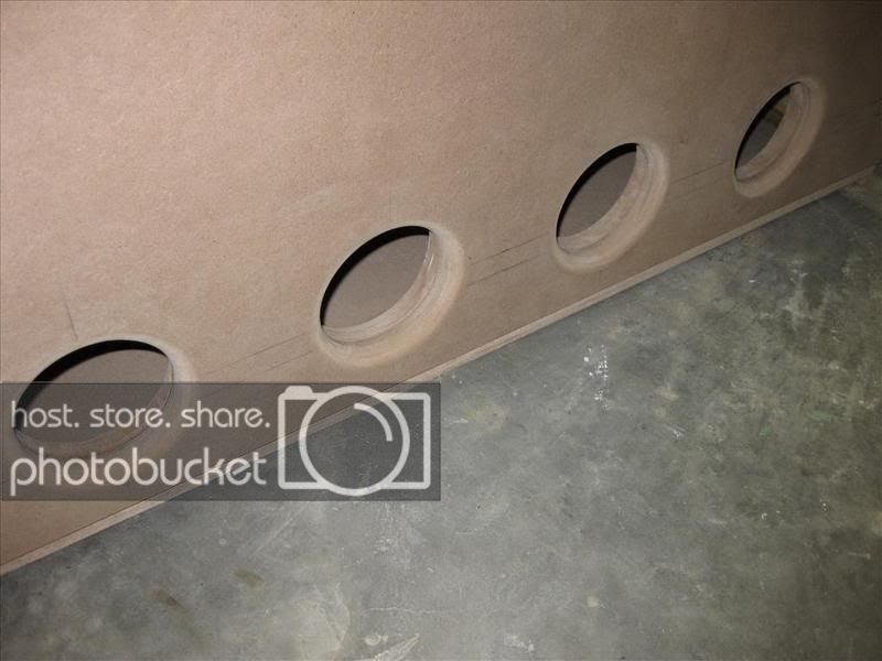

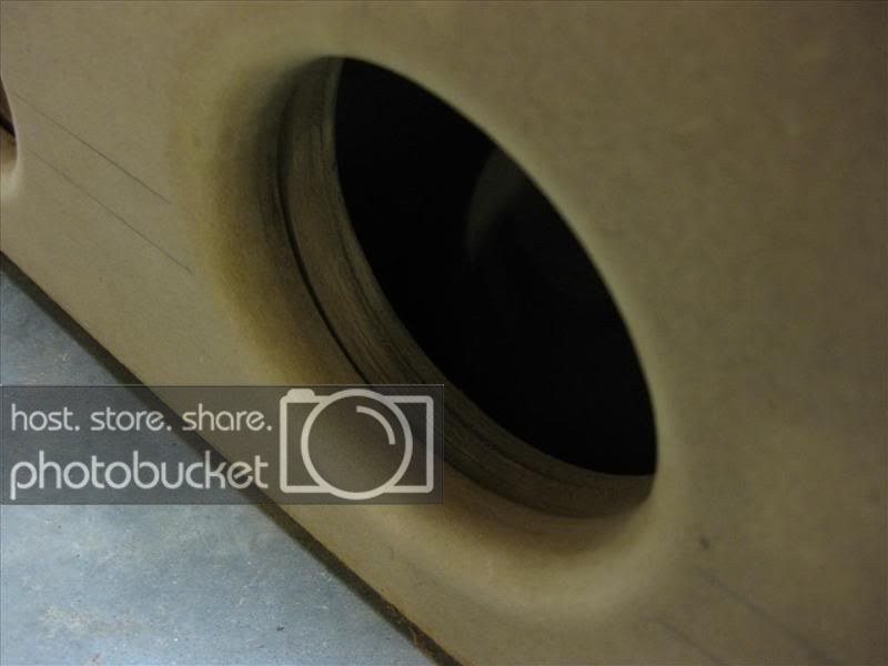

Tonight I had some nice progress. I got the drill press and got all my holes cut and the ports flared/rounded. I also filled in holes and a few indents with sawdust/glue paste and sanded most of it smooth.
Tomorrow I plan to cut and install the ports, glue the front and hopefully top baffle, and get the terminal cup in. It might be test functional later tomorrow. Anyway, heres some pix.
What do yall think so far? This is all funded and built by myself.

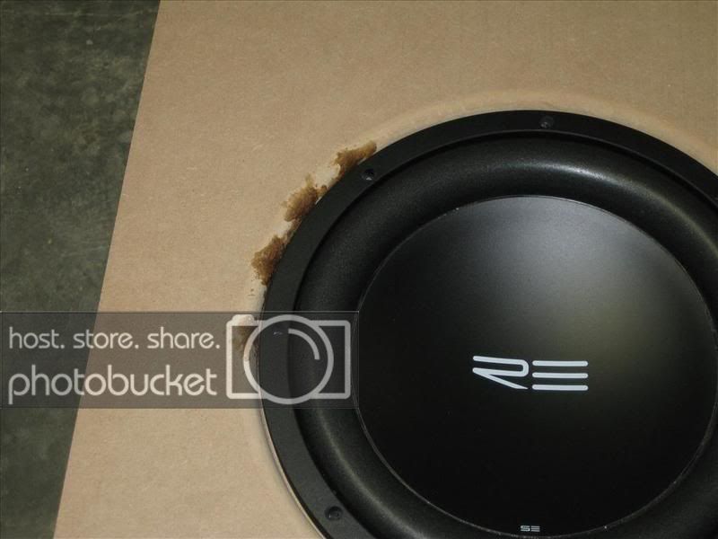

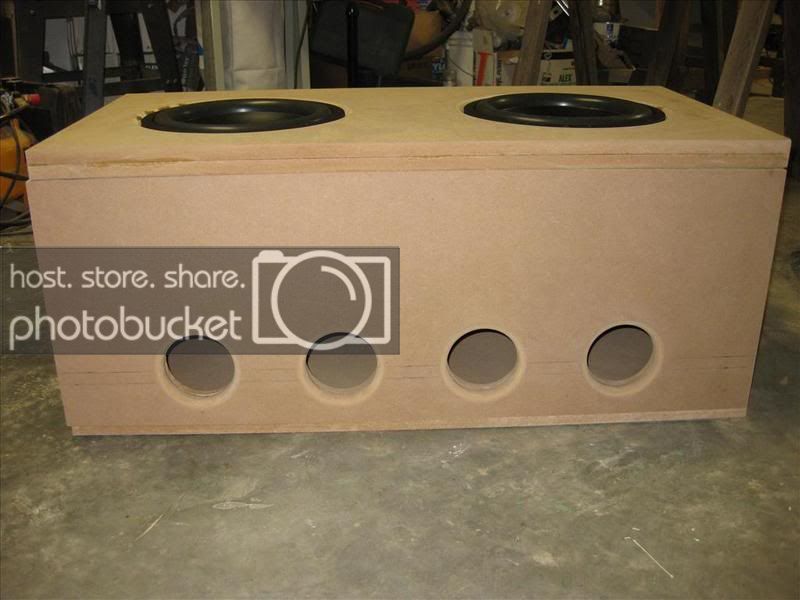

Getting closer...

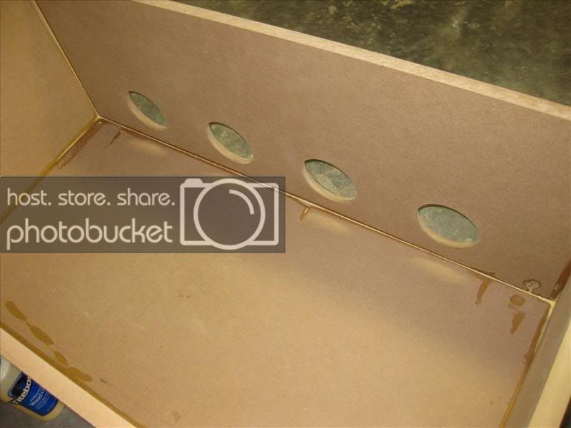

Front baffles on, and inside port holes have been expanded 1/8"

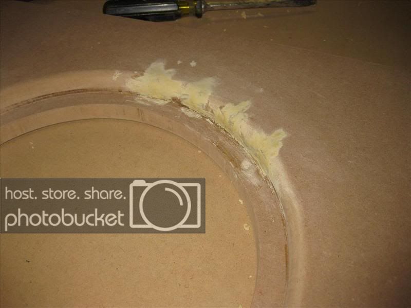

some bumps glued and puttied

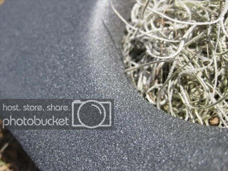

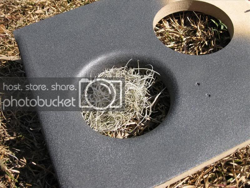

Heres some of the paint im considering.

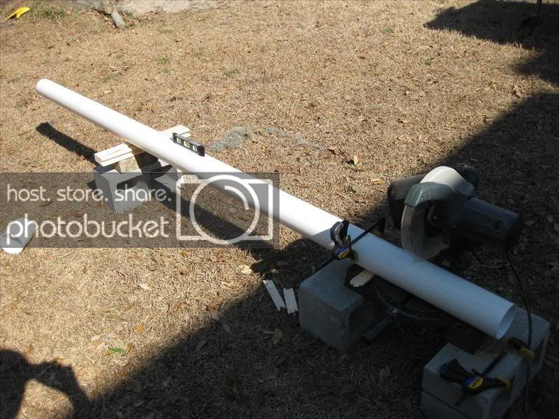

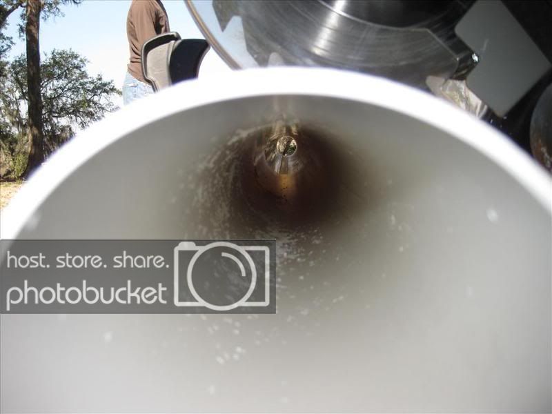

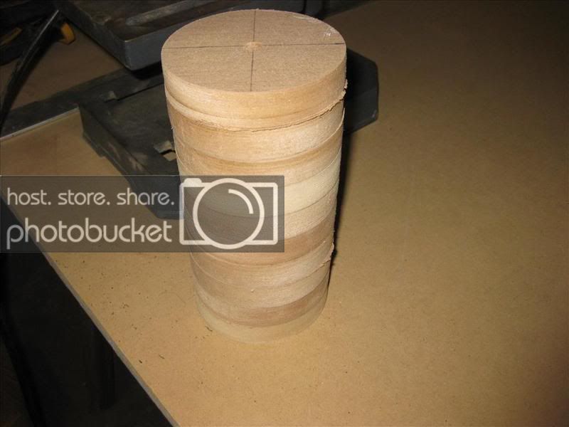

My pipe cutting setup.
