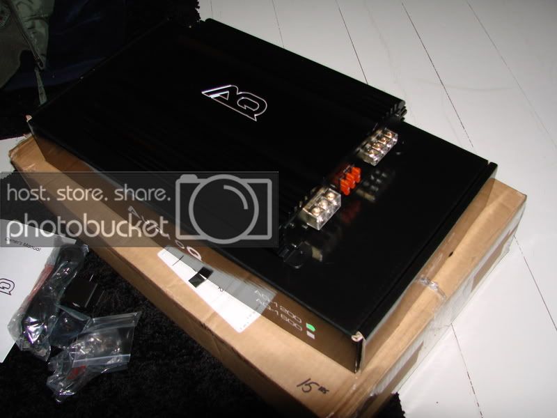

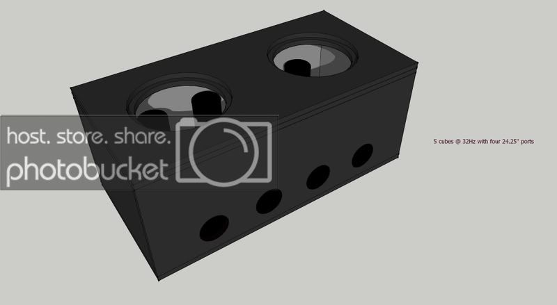

I'm running an AQ1200d right now, and want to up my power a bit some day. Heres my design. It's 4.96 cubes tuned to 32Hz and using four 4" PVC ports with rounded over ends.

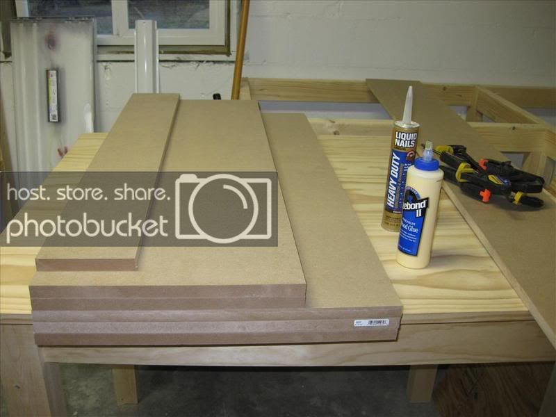

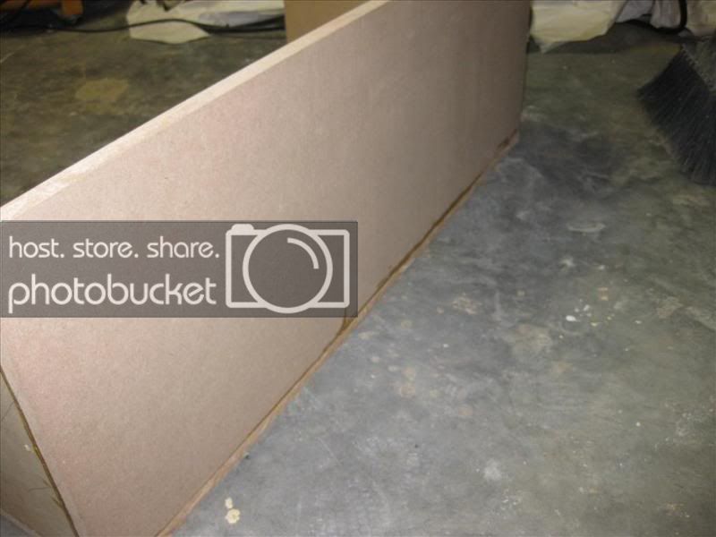

I got all the cuts done and ready to go.

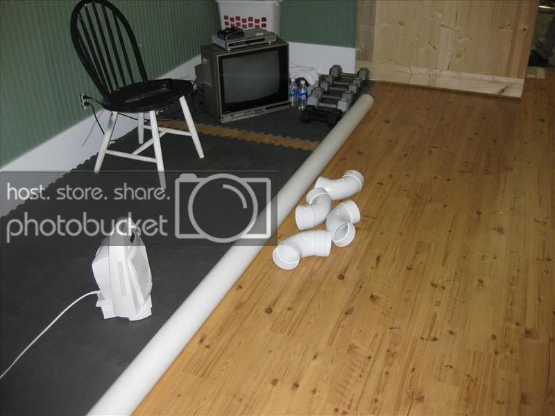

Heres all my port materials.

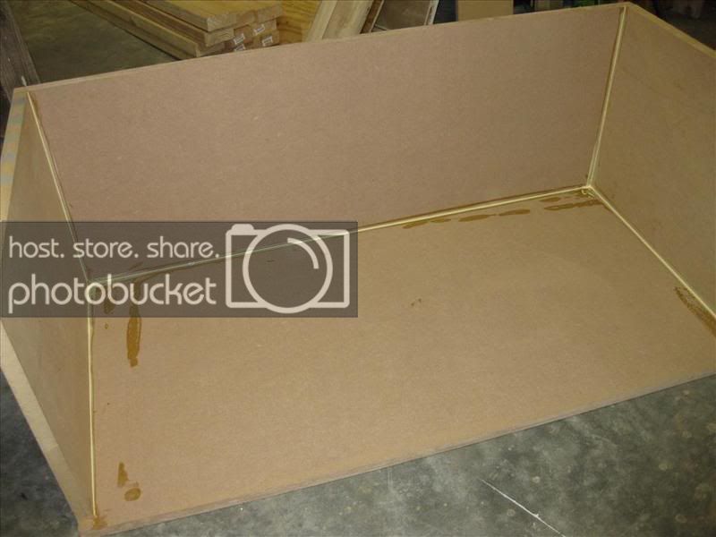

And the assembly of the first few pieces.

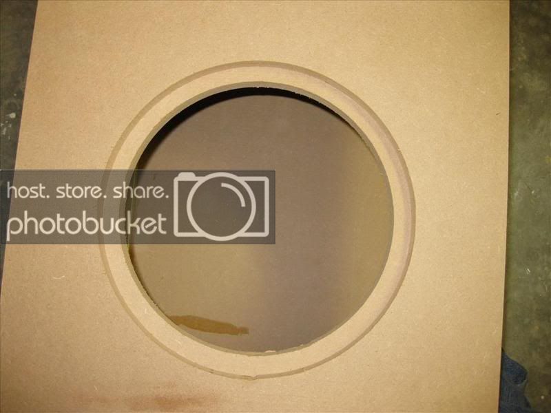

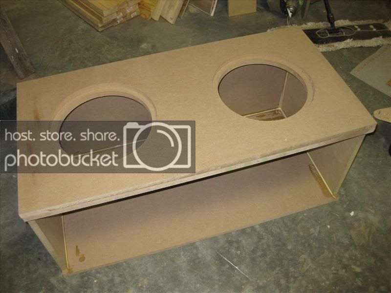

Heres a mock up of the baffle, I'm not gonna glue it till I make sure it works with the SEs that are in my car.

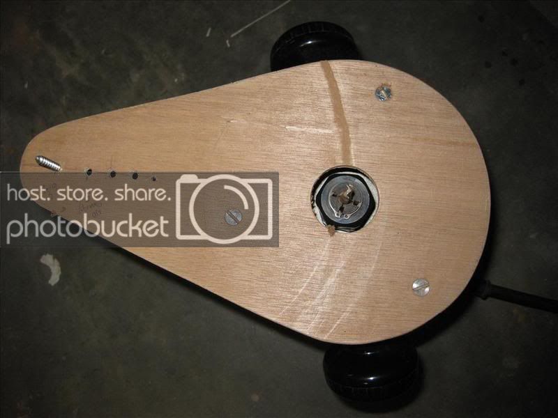

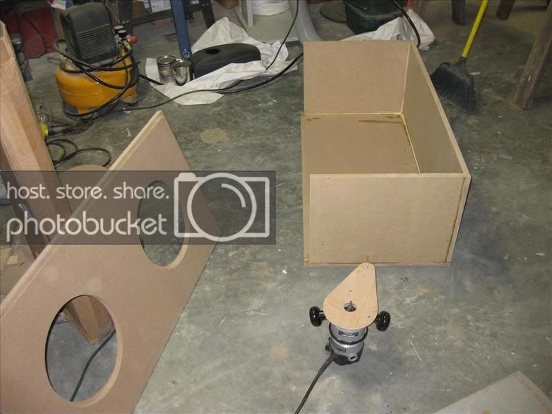

I ran into a problem... I use this thing I made for the holes, but It wont cut a 2" radius for the 4" ports....
How do you guys cut out good circles for 4" ports? I need to do 4" and 4.25" cut outs?
i ran into the same problem when tryingto cut out rings for my door speakers i went and bought a smaller router. i put a 15 in my gf escape how is your voltage with the 1200 and the600.4
I did the "big 2" with 1/0 and both my amps are running off 4 gauge wire (I'm running another run of kicker 4 gauge soon) and an 8 gauge ground (yikes) but lowest i've ever seen in drop at idle was 13.1.. so not bad considering the conditions. Thats at full tilt with a tad of clipping as well.
And I can't really afford to get another router, anyone else have any ideas about the 4" ports?

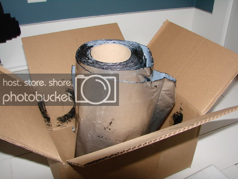

yea i just toss everything in there a couple weeks ago and if i point the box back it rattles because i havent done any deadening
I put in a bit of deadening on the metal and I adhered some styrofoam to the plastic panel because it rattled too, and it helped but subs back still rattles a ton lol. Subs up gets the immediate roof going good though haha.
for anything I under 5 inches i use a whole saw. you can go to harbor freight and get the same set I got for around 10 bux
Ok, I was thinking that's my only way. I'm sure they make a 4", but what about the 4.25" cut? just go back and sand a 4"?
