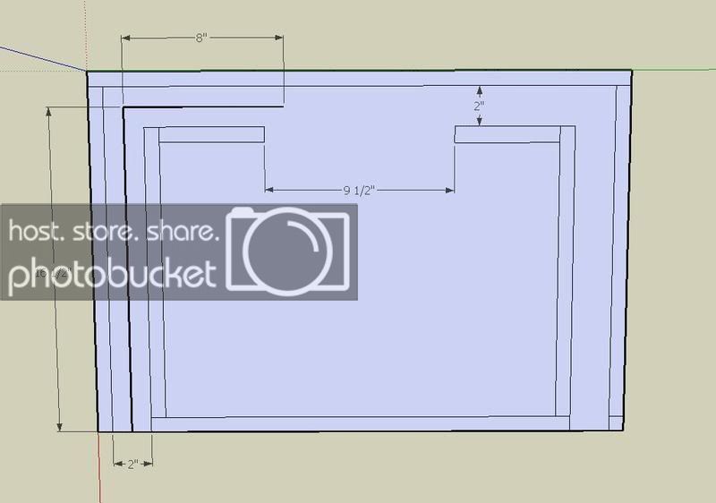

Can someone at least double check my work?
The outside dimensions are 18.25" D x 27" W X 16" H
Inside dimensions are 16.75" D x 25.5" W X 14.75" H ~3.5-3.6 Ft^3
I want it tuned to 40hz, WinISD says this set-up would be 39.86.
The real question is actually if WinISD includes the end correction of 1/2 of the port?
All of the numbers plugged into WinISD shows that it's 24.5" Port Length for 2 ports @ 2" Wide.
If you're going with that box design why not make it .75 wider and add a wall to make two chambers. it adds support and if one woofer blows then the other won't have a higher chance of blowing
Lmao, good point. I guess I've always done double/triple chamber boxes and wanted a shared box.
