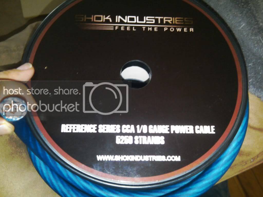

35 ft of Shok Industries ran throughout

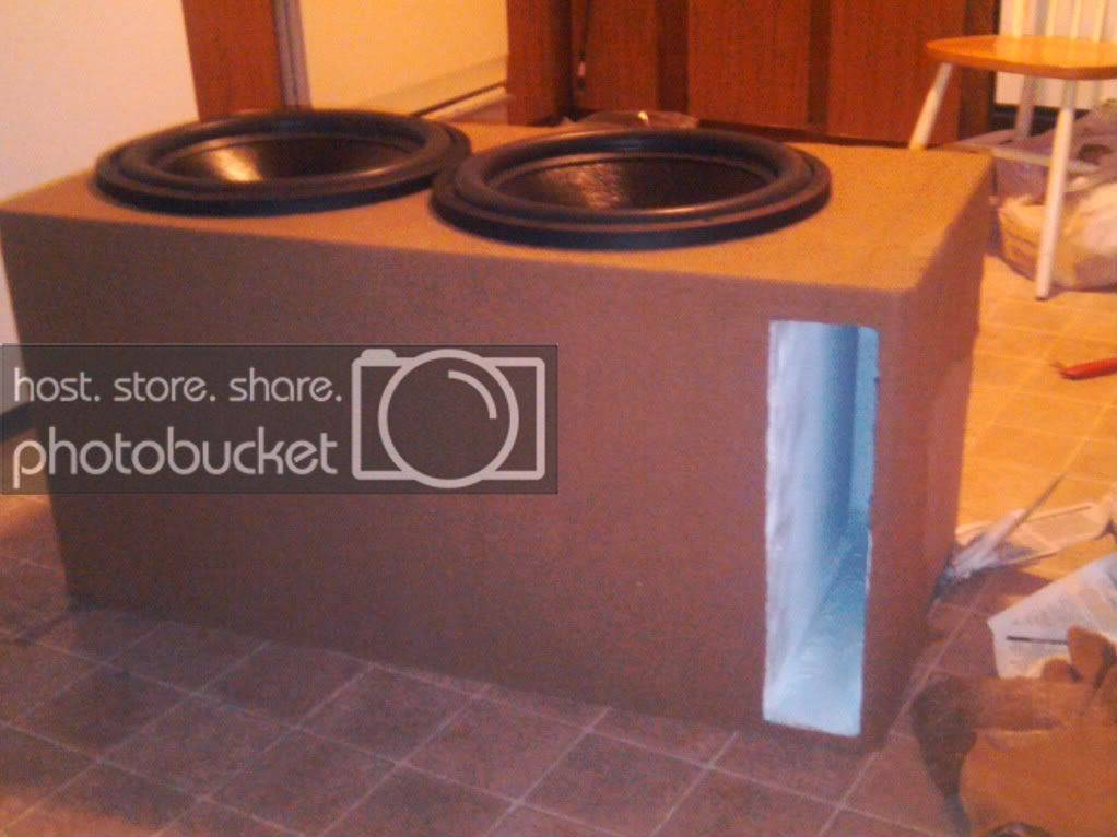

I recently wrapped the 10.5ft3 enclosure in tan carpet and sprayed the port white to match the car. I wired the new Kicker 2500.1 up and got the Optima in under the hood. 75ft2 of sound deadening to the trunk floor/wall/lid. The big 3 and Shok 1/0 gauge will be ran as soon as i get to it as well as the install on the alternator and battery/battery rack.

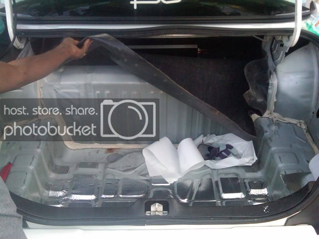

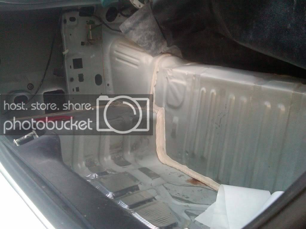

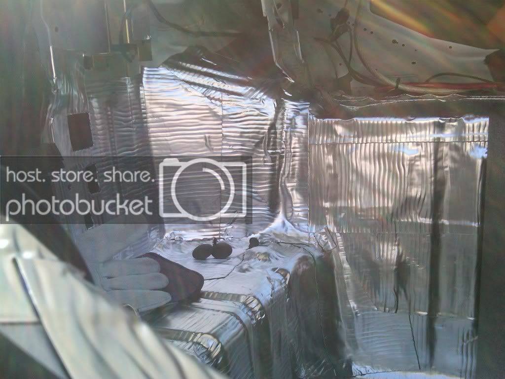

The trunk getting started on with sound deadening...its a big trunk and wasnt much fun
almost done

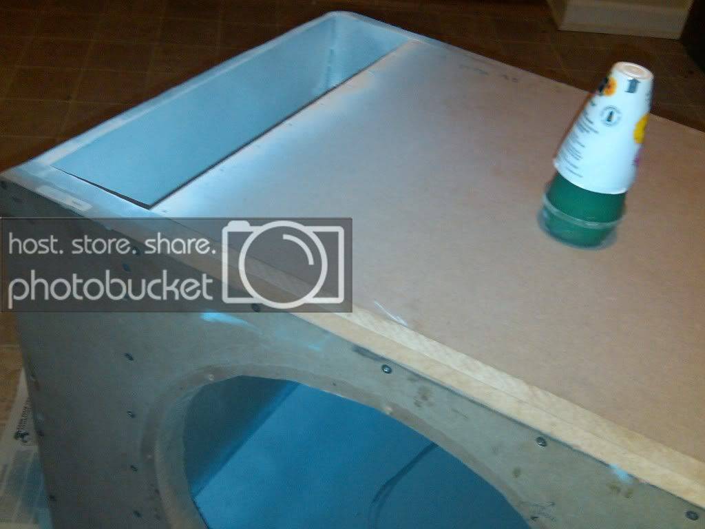

box ready to be wrapped and painted
10.5 cubes tuned to 32hz
port being painted
box finished and ready to be wired up again

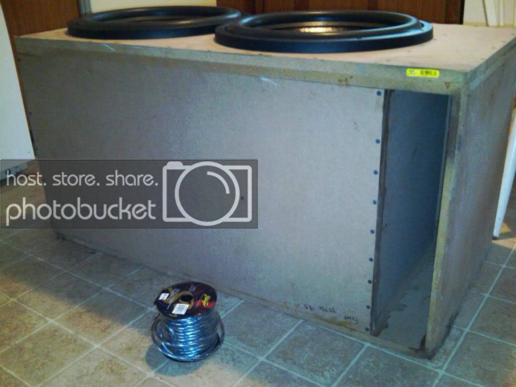

wired up and snug in the trunk after finished sound deadening. Im planning on changing the location of the amp from behind the box to the very front so its visible. Ill change it when i get the battery rack finished up.

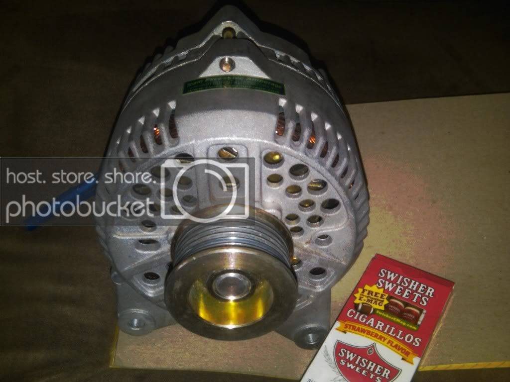

EA 300 amp alt and my trusty swishas
Shok Industries 1/0 gauge goin in throughout and in Big 3

RV roofing repair mat. I love it...this is the 2nd vehicle ive had that i used it in. it hushed up some the smaller rattles and noticed a lot less road noise comin from the trunk as well... did the whole trunk for i think $30-45 range.
Link for it online? Lol
Was going to do the second skin thing...BUT if I can get something that costs less...that would be nice.
i got the rv roof repair at home depot. took 3 rolls to do my trunk ~75ft2 and roughly 35$ if i remember correctly
