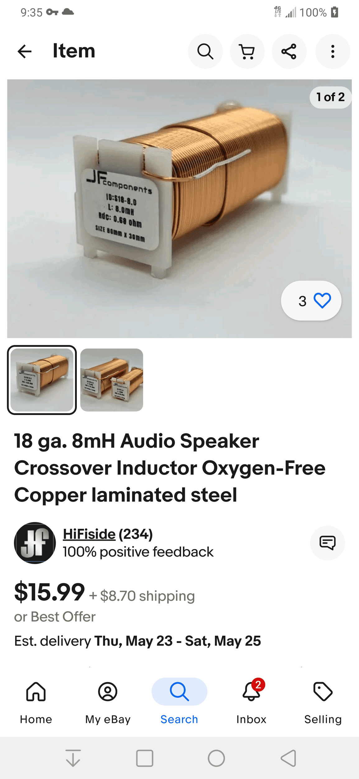

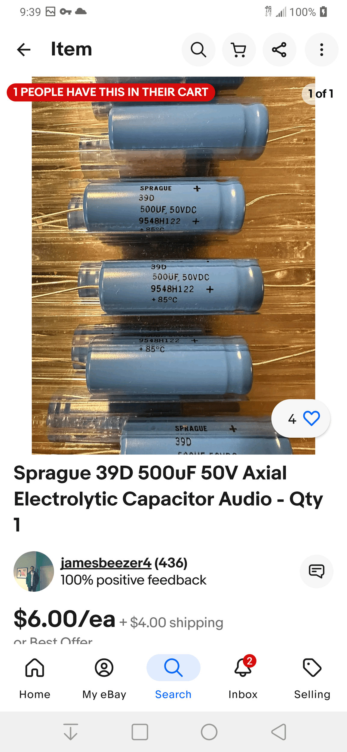

This is a feature that uses passive crossover components. On the full ranges you use bass blocking capacitors, and high frequency blocking inductor coils on the sub. It is just like using 2 or 3 way components with a passive crossover network.
You still have to follow the Ohms specifications. 2 Ohms lowest per full range and 4 Ohms for a bridged sub.
View attachment 58617View attachment 58620
