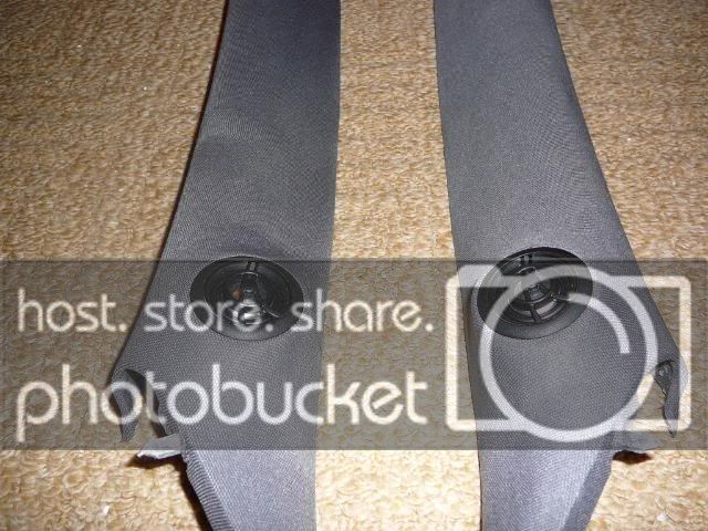

Each install is completly different. If you put your tweeters in the same spot mine are in they may sound like garbage. I would seriously consider using velcro till you find the location you like most.
You should try a temp install using either double sided tape or some other way of temporarily mounting the tweeters to different places and see how it sounds. That way, you find the best location and you aren't left second guessing yourself.
