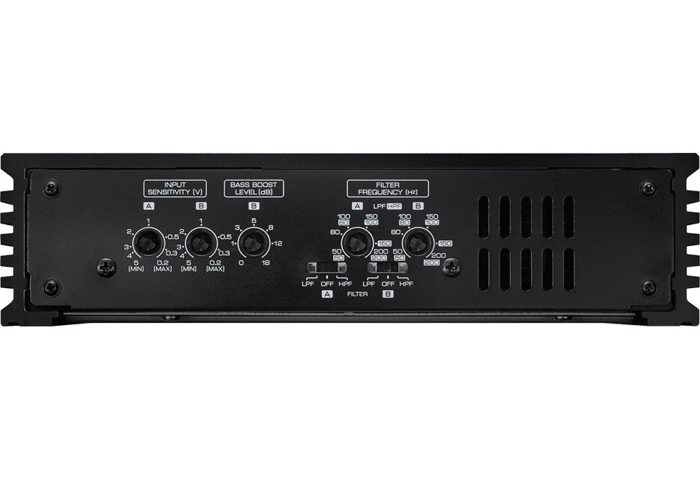

Just out of curiosity, when you say turn up the gain, are we talking about the input sensitivity?
