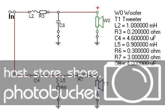

Yeah I saw that when I was on the site earlier today, and I don't agree with his assessment. He's padding the shit out of that woofer at high frequencies, which is exactly the opposite of what I and PE have done, and is using rather high inductance values based on what he thinks the driver will do at high frequencies. Based on my initial thoughts, then mine and PE's response plotting, it doesn't appear that that'll work.
How about a basic simple crossover I can start with and then go from there? Like something that will work, but then let me work on tweaking it myself. Like maybe a 2500-2750Hz Butterworth design?

That is what I am considering, but starting without an R7 then trying a 3 ohm like the person recommended. Wht are your opinions of trying that?
