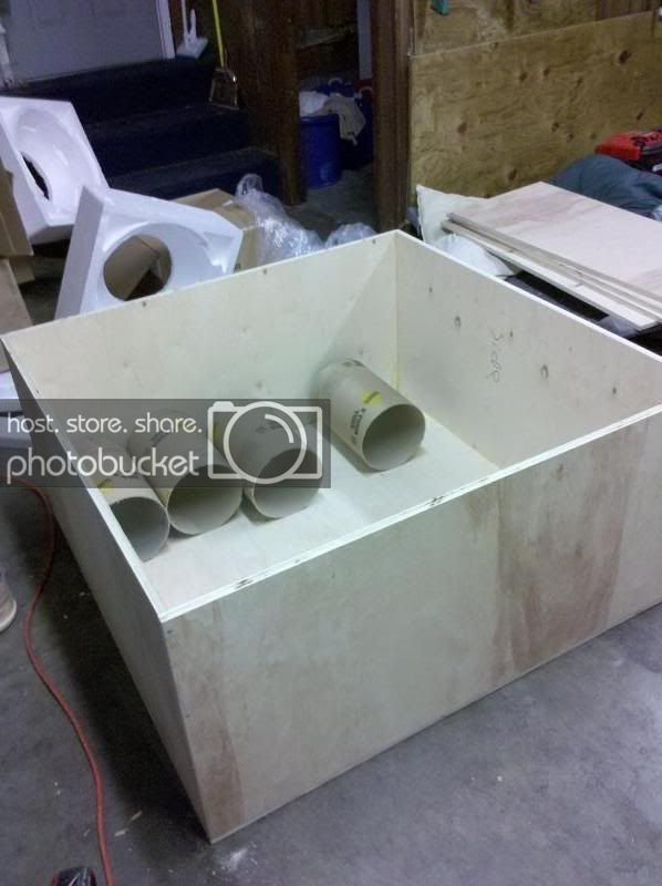

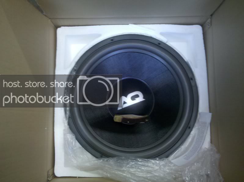

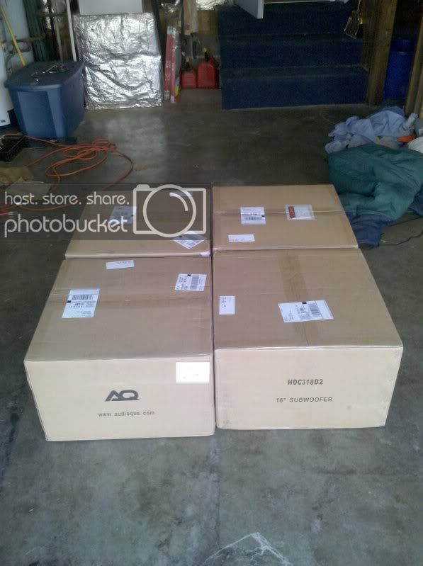

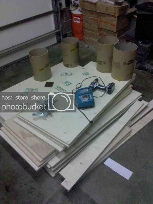

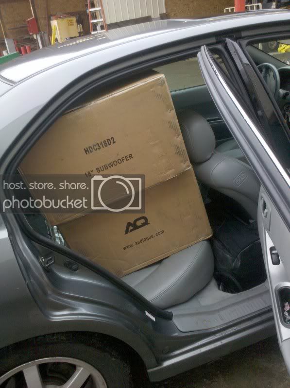

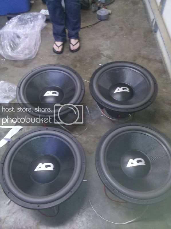

This is my bro's build we are hoping to have the box built by tom. or friday. The box we are making will be 24 cubes tuned to 38Hz with 4 - 9in. sonotubes. For power he is running 2 older AQ3500Ds @ .5OHMs a piece. He has the stock alt and a kinetic 1800 up front and 2 HX400s in the back for now... Here are some pics
Lol... it was a lot or fun trying to put all 4 of these boxes in my galant
Dats a lot of woofahs
Look at that tiny KNIFE I mean gah dang thats a big woofah!

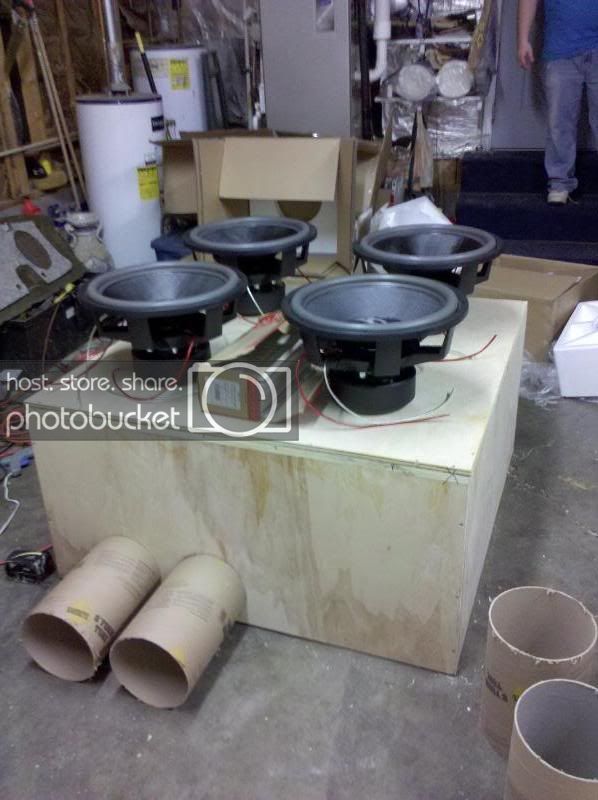

Yea its subs up port back. Going to get more wire tomorrow. Box is all birch double baffled on bottom and triple on top with bracing all around. We hope it does around a 153 or so at the headrest at a low Hz //content.invisioncic.com/y282845/emoticons/veryhappy.gif.fec4fed33b4a1279cf10bdd45a039dae.gif
your aint gonna get even close to that.
The minute your amps turn on, your stock alternator is going to off itself before you turn the volume up //content.invisioncic.com/y282845/emoticons/wink.gif.608e3ea05f1a9f98611af0861652f8fb.gif
no, but seriously, i'de definitely get an upgraded alternator before attempting to run 7krms, ESPECIALLY on a .5 ohm load.
more pics nigs. should be done and playing late tomorrow. will have an hd youtube video shortly after even though it will be turned down.//content.invisioncic.com/y282845/emoticons/crap.gif.7f4dd41e3e9b23fbd170a1ee6f65cecc.gif
need an alt bro. seriously i would put money on you dropping into the 11-10 volt range with that much power on the stock alt. just keep an eye on everything and use your senses to tell you if something is going wrong (smell is very important)
bro i have already ran the amps like this just the way it is on two hdc3 12's same impedance. dropped to 11.98 full tilt on music tiny blinks of clipping on amp. had so much power the spiders tore on the old hdc3 coppers we had. peaked at 35 hz and was way louder than my maxima that did over a 145 at the headrest at the same hz. i will clamp for power to once they are broken in all the way. im not that ignorant.
