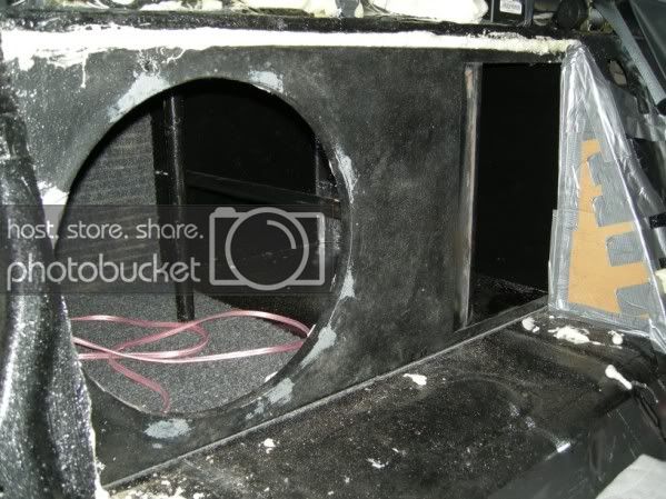

It all in the box
Sub and port placement
For spl you need lots of port area
Sounds like your tuning frequency is to low too, for spl try a higher frequency 40-50 hz (for SPL not Music)
