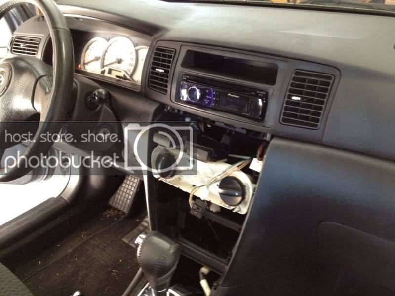

Working on the radio install.

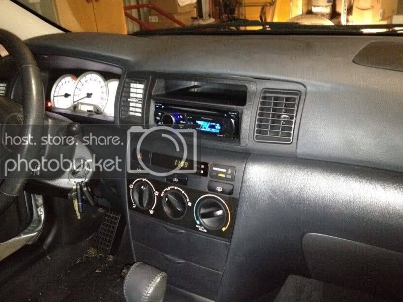

Got it all tied up. Looks pretty nice.

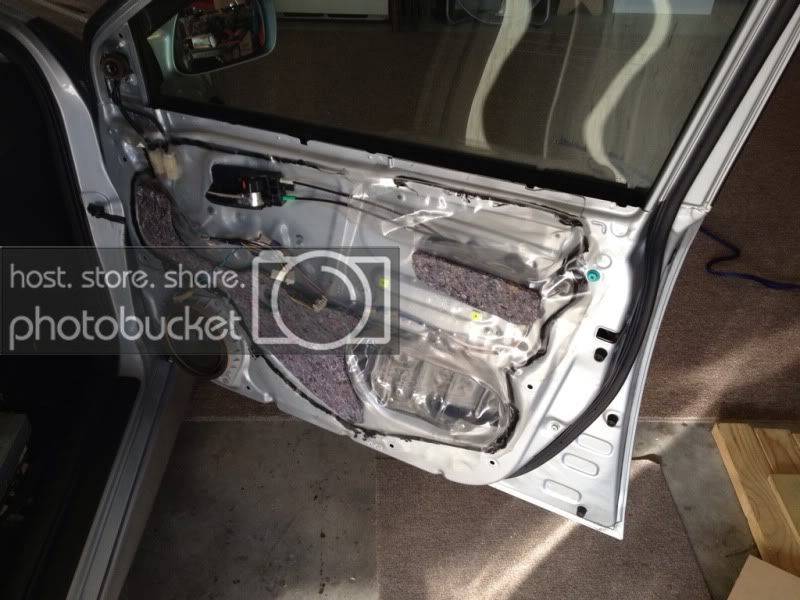

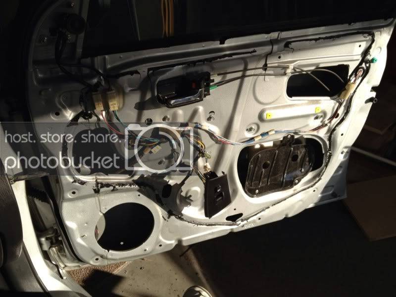

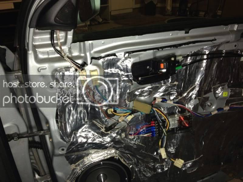

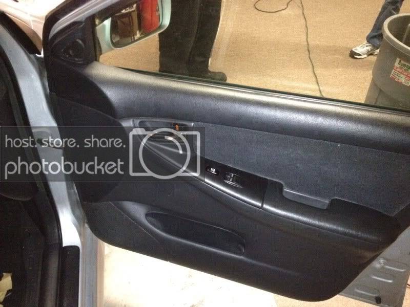

Started on the component installation. Heres what I saw when I took the panel off. Overall, the door prep and component install was definitely the most time consuming part of the install.
Vapor seal gone and speaker gone. It was riveted to the door, and was all one piece. No way to take it out except for drill the speaker out.

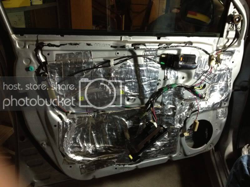

Did the same to the left door. Then started sealing and deadening the door.

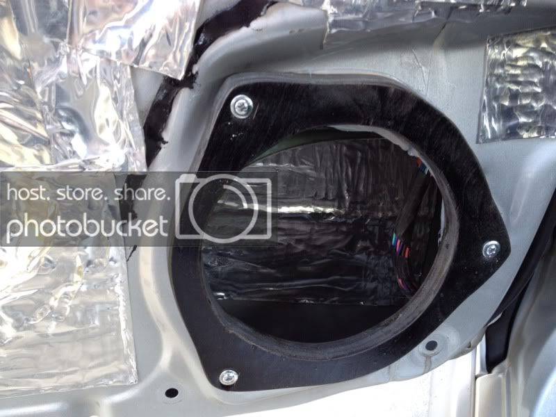

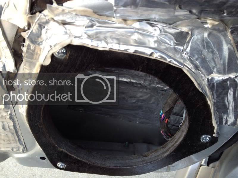

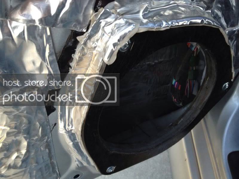

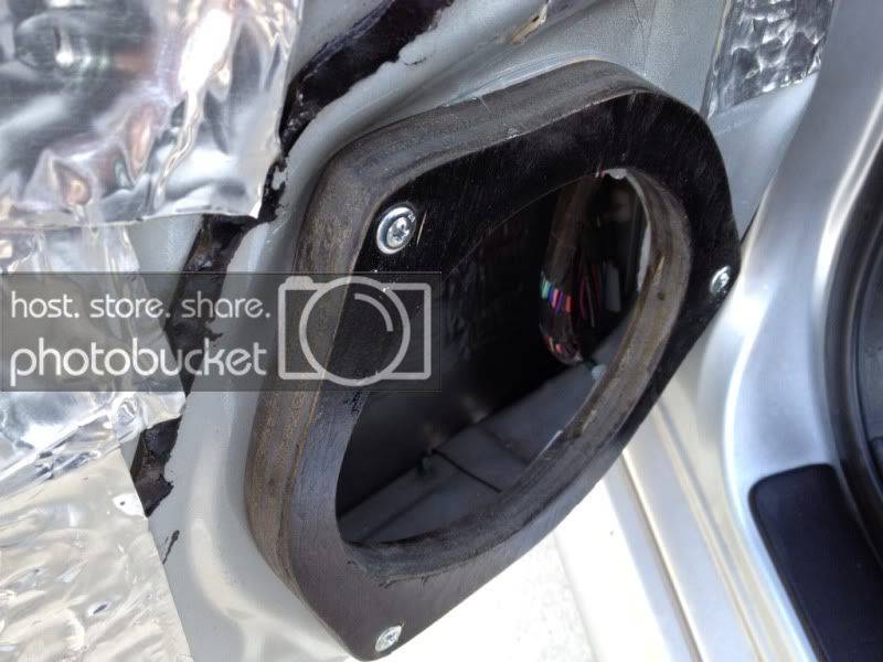

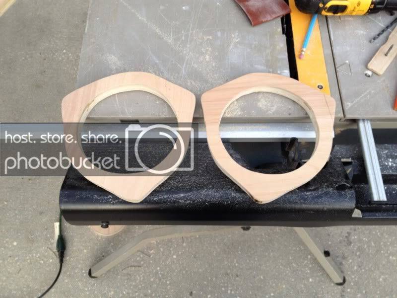

Needed some adapters since the hole in the door was too big. Also wouldnt hurt to have a little extra depth since the magnet was almost touching the window. Jigsawed some out of some scrap birch.
Quick spray with some black paint so you wouldnt be able to see them behind the stock grill. Used silicone to help adhere/seal to the door, then some self-tappers to hold it in nice and tight.
Super solid mounting point.
Sealed around them with more deadener, just to be sure.
Deadener FTW.

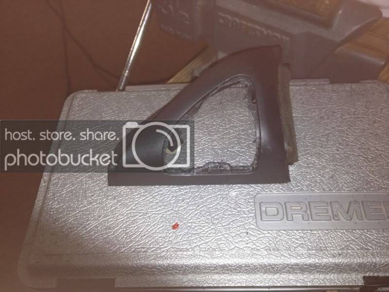

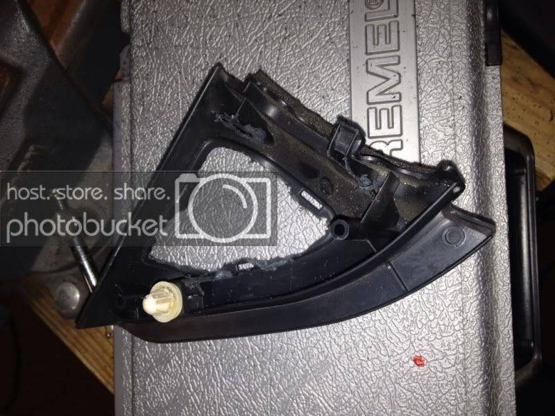

Tweeter needed to go into stock location, in the doors sail panel. It was originally a little .5-.75" crappy OEM Toyota tweeter. So had to hack up the inside of the sail panel to fit the huge 1.25" Focal tweeter. Left all the structural parts in it, along with the holes for the mounting tabs on the grill.
Dremel tore that thing up.

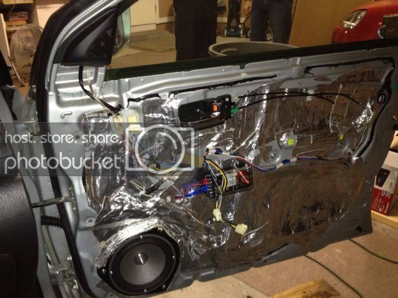

A little creativity to secure it to the metal housing on the door, then luckily the cover fit. Also mounted the 6.5" mid and the crossover. Started wiring everything up.
Drilled a small hole in the door to run the amp output right to the crossover, and to run the mid wire back into the door. Then ran the tweeter wire along the stock wiring, and ziptied it to the stock wires. Since the tweeter wire is secured to the stock wiring, I also secured the other wires to the tweeter wire, so none of them are going anywhere.

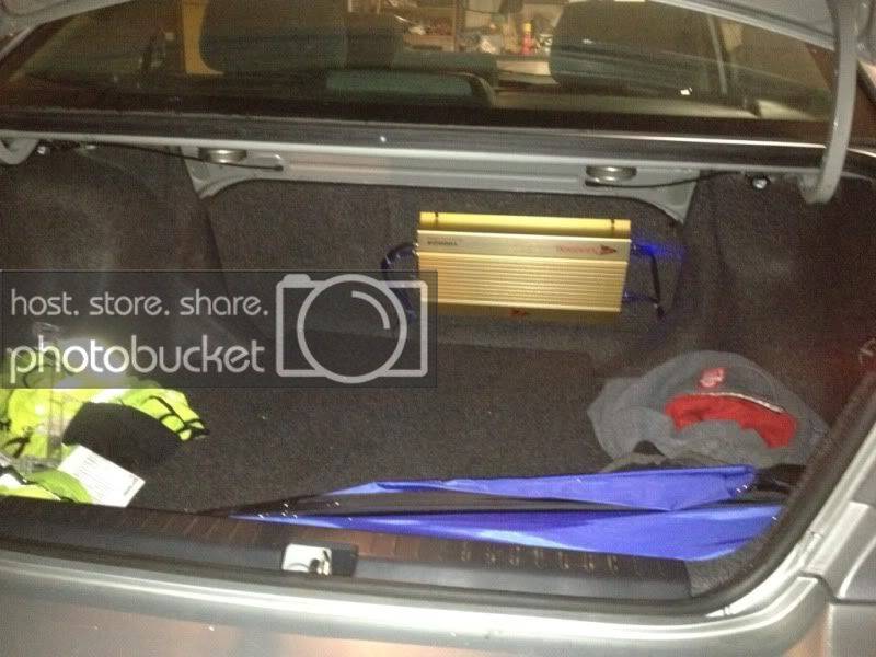

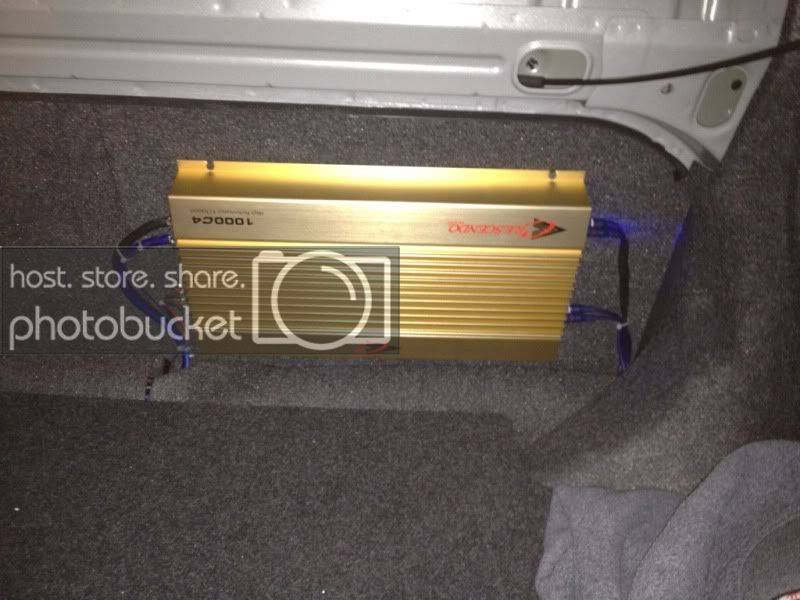

Mounted the amp temporarily just to get it playing. Ziptied some of the wires up and tried to hide them best I could for now.
Just secured to the back of the seat. Actually has a decent sized trunk for such a small car.
