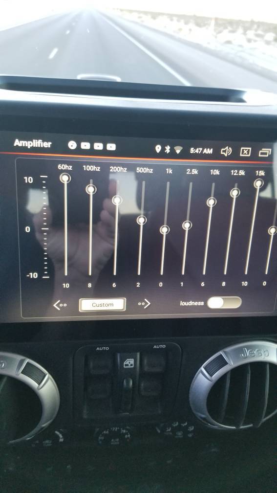

The pic is just for reference.

Tell me that is not your EQ

yikes, there's your other problems all in one... Looks like you have a chinese android unit which is a complete sh*tty and dirty signal from the start, dont even hope getting anything worth while from that, literally a swap to any proper head unit will yield massive gains in SQ, SPL and overall bass frequency response. 1.5 volt pre-out is pretty bad, it'll cause all sorts of distortion and weak bass response, from my personal dealings with head units with weak pre-outs, it makes huge difference.
2nd is your EQ which is literally using bass boost, that 60hz should be at 0
Yeah I was afraid of that with the HU , I dont know what I am going to do. I love having the android HU but it has a crappy output .Wish they would have better audio components in them. I'll have to work on it . Thank you for the help! BTW I run that EQ Flat , I have a Audio control Dm 810 usually in the system. But the USB port took a dump so I sent it off to get fixed.
