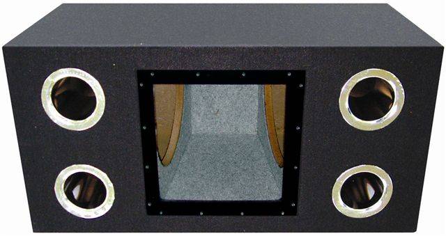

Im really wanting to get a loud setup and get something to scare people. Im sure thats a goal we all have in common, Lol. But right now my current setup is 2 JL W0v3 12's in a bandpass box, Hifonics BRX2000.1d, 0 G wire, Big 3, Kinetik 1k, and JVC xd320bts head unit. It sounds decent right now, but i know that its too much power for the subs ( Rated 300w /e ) and it really starts to distort and sound like **** turned up. What suggestions do you guys have for me, Im looking for money well spent, Not cheapest but the best things to upgrade and get loud enough to scare some people.

If you have this type of bandpass box, Thats your problem.

You dont have the space. A proper loud enclosure requires much more space than you can possibly fathom and the box is what gets you loud. If the box suffers due to lack of space, then your overall output would be cr@p. If you want to cram 15s in there, be prepared to give up your every last inch of your trunk space. That includes spare tire. Along with cutting some metal and building the whole box inside the trunk aka permanent build.
I'd seriously hit up Mylow's DD9512s Those are nasty subs. Put them in a 4.0-4.5 Net cubic feet enclosure after sub and port displacement(thats around 6 cubic feet+ before displacement) and get a 5-7k amp(with electricals to back it up) and you'll be flexing windshields, moderate hair movement etc..
