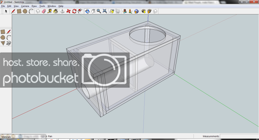

thoughts.
RangerDangerV2
1 cu ft tuned to 36hz for a memphis hpo10. thoughts?
not sure all that bracing is needed for such a small box. Is it drawn to scale-looks alot more than 1 cube if thats a 9" circle.
bracing never hurt anything. the brace for the port is needed because the woofer is loading right off of the port. and yes my math is on. it looks bigger because of the triple port baffle, and port and woofer dis. need to be taken into account.
didnt relize that was a triple baffle-thought it was another brace really close to the side. Is 2.25" really needed for the port?
The HPO is not a high excursion driver so keeping the port area, tuning, and net volume is check is very key. If you don't you will find yourself with a damaged HPO do to passing the mechanical limitations.
thus the 1 cu ft and smaller port area than what I would normally do. what do you think man? this is for one of the ones that you sold.
