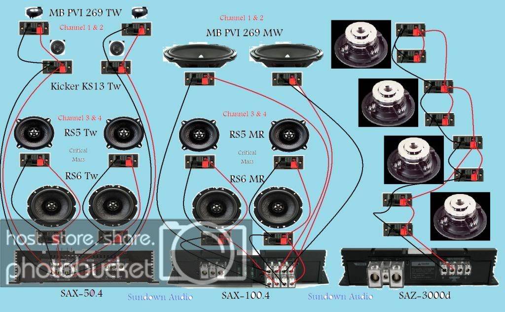

Thoughts on wiring setup.
Curious if anyone has any positive / negative opinions strictly on using this wiring schematic.
Everything will be running fully active off Lanzar OPTIX10.. RS5/6 by Critical Mass are coaxial, cut off capacitors and running tweets / midrange seperate. That is a total of 8 tweeters, 4 mid range, 2 mid bass, and 4 treo ssi 12.44.
seems like you'll be ok for impedance - 2 ohm stereo for tweeters and mids, 4 ohm stereo for midbass, 1 ohm mono for subs... assuming the speakers are all 4 ohm.
not sure why you want to do this, but it should work as you intend. thanks for the sketch, makes it a lot easier to understand what you're doing.
actually 0.5 ohm mono for subs until I can get the cash together for another 3000d.
All of this is front stage, no rear stage... and why not? lol
