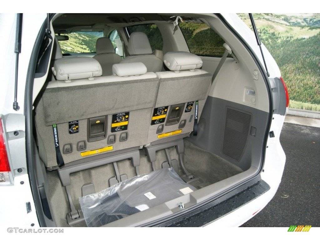

its a Sienna Minivan Technically i have my curent box technically in the D pillar section behind the 3rd row seats and a few batts.
This is a pic for reference, its not my car year but it should give you an idea
Current box is 39 Height x 38 width x 23 Depth with 200 sq inches of port area tuned to 35hz. with enough space to store some group 31 batts on the side stacked up.
C pillar behind the 2nd row seats, i have 46 height x 44 width x 47 depth max However after 40 depth the top hatch bends in which reduces the width and height down a little bit. Keep in mind I already subtracted an inch from each just for safety and fitment precautions. If I were to do a full fit its 47h x 45 x 48.
I can get even more depth if i move the 2nd row seats forward which i can squeeze out 4 more inches of depth.
I also have that whole dip in the back hwere the 3rd row seats fold up to store my amp and my battery bank.
