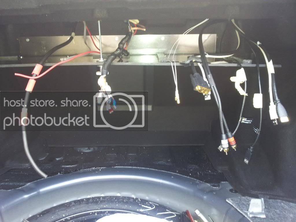

this is what I plan for my next system build. Opinion please
I have a infiniti m35. I currently installed a kicker kx650.4, two 10" sas el bazooka and a cheap loc. I was using sas bazooka from since the 90s. I like the bazooka because they are not heavy and sounds good. Since one of my bazooka surround is damage and 1 of 4 channel is intermittent on the kicker, I decide to do over my system.
I want my system to thump harder than what I was accustom to in the past. I plan to get a ported box with a maximum width of 30". The port hole must be in the center so I could open the ski hole in the middle of the backseat. This is what I came up with so far.
