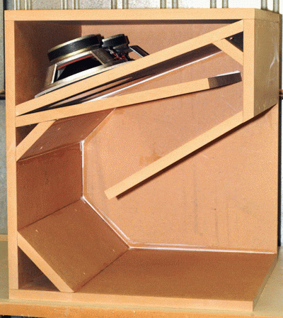

This is a horn.

Please take note and everybody stop ******* calling a bass reflex box with a flared port a horn.

Ok, I have to ask. What sort of formula do you use to tune that? It looks like its a continuous slope (angle) that's twisted in on itself?
Well not quite. The final angle seems more obtuse than the first. But the first two look similar if not equal.

AFAIK the flare is not supposed to be a straight taper but flared like a trumpet. Very gradually for most of it then flaring dramatically at the end. Many of the DIY applications are these tapered horns which aren't even a true horn with a smooth flare, but they replicate it close enough for simplicity of build. The actual angle isn't important and just however you can fit the horn in the space allowed (for folded type horns). What's important AFAIK is the rate of expansion towards the mouth.
The math behind this is beyond me, but I know for large woofers and low tuning size is generally impractical for the car. Search some home and pro-audio forums to find the real experts who have built true horn loaded subwoofers. Horns are insanely efficient (ever sit in a Brazilian's car with 2" horn type mids and tweets?)...picture that scaled up.
The key features of a true horn are a driver in a very small sealed space firing into an extremely narrow throat which tapers out to a very wide mouth.
