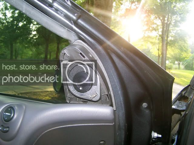

Right now they're mounted like this. In the stock tweeter housing modded in
Quite frankly they're too harsh even at -6dB

Is it possible to aim them more off axis (ie not at your head)?
Did you try wiring them out of phase with the mids?

Why not grab yourself a roll of 3M double sided tape, and position them all over till you get the sound you want? I never understand people just throwing things in a car without testing, especially tweeters where placement can mean nice crisp sound or an ear bleeding rusty nail on a chalk board sound.
Id suggest going just over the speaker grill in the car door, as I did with my car.
This way, their off axis and not pointing at your head, IMO it should yield a better stage and shouldnt be soo harsh.
I still think the gain is too high, especially if their still that loud at -6db.
As FoxPro suggests..I would definitly try reverse polarity wire of both tweets - Not sure if the SLC ownrs manual suggests this, but i have seen it in other Rainbow manuals if you choose to mount them away from the mid. I can see this taking some edge away. But other than say a large format/poor off axis home audio tweet, theres really no need to have a compact dome directly on axis like that.
Also noticed your midbass is located rather high in the door. You may be experiencing boost from your cabin/ locations in the 1k-4k range- this is the area where the ears perceive as harsh, are most sensitive to. Do you have anyway to adjust the trebble?

havent tried out of phase. Dont like placement elsewhere. when I first installed them I had them on the dash. still was harsh. I tried taping them in various places. still was harsh so I just set it to -6dB and placed it there. Maybe my hearings just sensetive. The stock tweets were also harsh to me.
My factory stereo has a 3 slider eq. I set the treble down to barely tolerable levels. Yeah my speaker locations is high and to the middle compared to other cars. And the speaker doesnt mount to the metal door frame at all. It mounts on the plastic door panel. If you take one of the mids out you'll see a flat sheet area of Damplifier. theres no real "pocket" for the speaker to go into.
