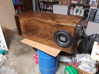

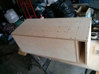

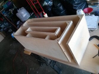

A few pics below shows a T-line enclosure which I built for myself a few yrs ago made from 3/4" baltic birch which is about 40-45 for a 5x5 sheet here. It took 2 to make this box, almost 100 bucks. 3/4" MDF is the popular ideal choice wood for making boxes....it's cheaper but it's effin messy and heavy. Depending upon of type of birch you get, some has a really nice finish, cabinet grade type is usually higher quality, void free. In this case, I wanted to try something different than the paint or carpet method. Stained and polyutherane'd the box later. It's the poly (clearcoat) that really brings out the color of the stain. Much like switching from reg TV to HDTV.
