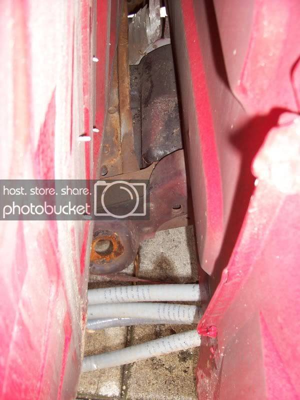

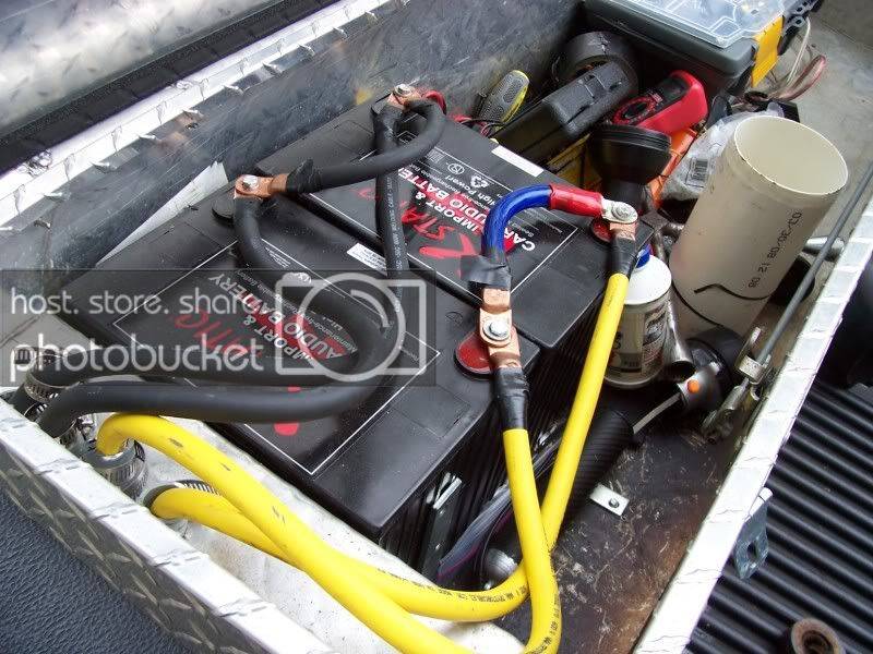

I ran it through the bed rail in the old truck. Pictures are after the truck was totaled, so that that's why it's all out of shape.
Yeap, I drilled through the tool box and bed rail. Then the wire came up through the floor of the side panel and into the cabin. I used 90 degree elbows and stuff to keep everything in place. I'll see if I can dig some more pics up.
